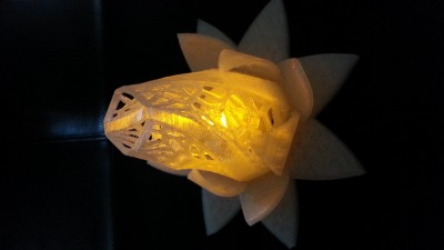

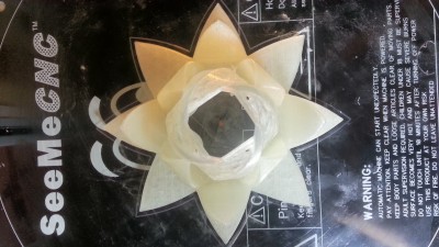

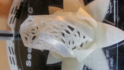

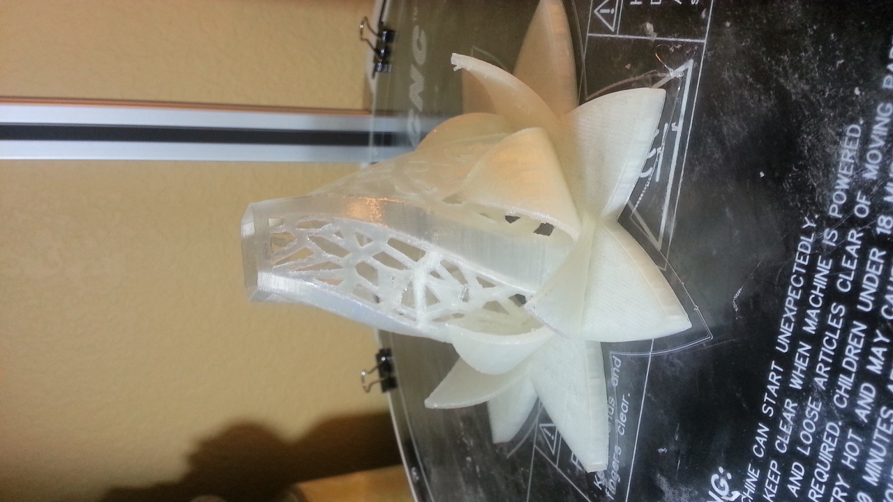

PLA stringing has been driving me crazy. After spending about 20 hours of making small calibration tests to get rid of blobbing and stringing (ABS is so much easier to work with!), I think I finally got this working to the best of my ability. I reduced stringing about 90% and was still able to print at 180C. Oddly enough, speeding up the print, lowering the Z-Lift, making it retract just about every non-move, and a few other filament tweaks such as having no length on restart seemed to finally make the difference for me. So, I went ahead and took on a big challenge with the Petal Vase. I was very happy to wake up this morning and walk into the cave and see this sitting there.
Couldn't be happier, and more importantly, my wife was happy with what I printed her because I've been spending a little bit too much time with my new girlfriend RSMV2
