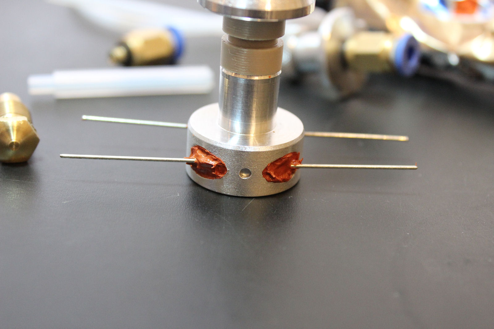

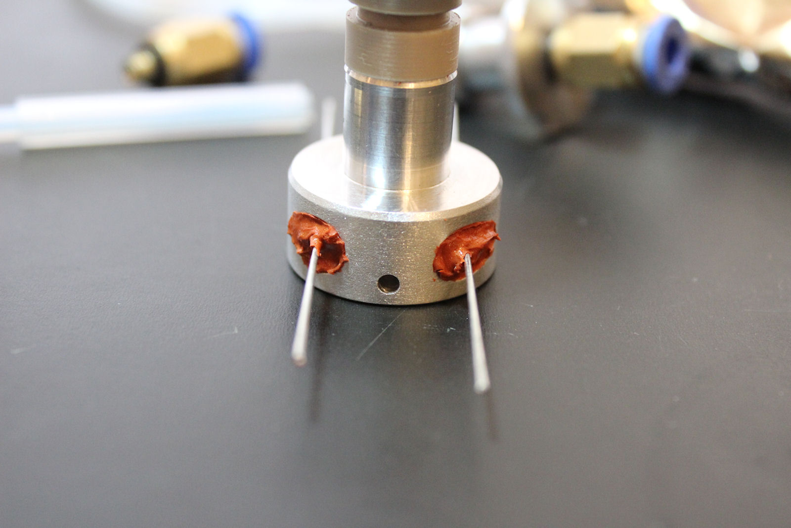

I am in the midst of assembling the hot end for my Rostock MAX and my "perfectionism" has slowed progress to a crawl. In the assembly guide "geneb" indicates that the thermistor should be installed in one of the holes perpendicular to a heating resistor. That would be this location (see middle of photo):
There is another hole in the hot end where the thermistor can be mounted (see middle of photo): This hole is much deeper (>5mm) and will easily accommodate the thermistor with PTFE tubing on its leads. The depth of the hole is such that the thermistor will contact a surface about 1mm from the threads on the nozzle. This allows the thermistor to meter the temperature of the nozzle almost directly (a more reliable measure of the temperature of the nozzle). With a nice dab of RTV the thermistor will mount very securely. I'm inclined to mount the thermistor in this second location.
Am I missing something?
Bill
Two things occur to me. In this location the thermistor's mounting is very precarious; it's going to take a lot of RTV/Kapton tape to hold the thermistor in place. More importantly (I think?) the thermistor will be measuring the temperature of the heating resistor, not the hot end.There is another hole in the hot end where the thermistor can be mounted (see middle of photo): This hole is much deeper (>5mm) and will easily accommodate the thermistor with PTFE tubing on its leads. The depth of the hole is such that the thermistor will contact a surface about 1mm from the threads on the nozzle. This allows the thermistor to meter the temperature of the nozzle almost directly (a more reliable measure of the temperature of the nozzle). With a nice dab of RTV the thermistor will mount very securely. I'm inclined to mount the thermistor in this second location.
Bill

Re: Hot End Thermistor - Which Mounting Hole?
The holes that intersect the bores for the resistors is a relief hole. It allows air and silicone to escape from the bores as you insert the resistors. At the build event, it was suggested to inject the silicone into these side holes to insure there were no voids. These new openings are a relatively new addition suggested by Eric (?) to reduce the possibility of hot spots due to trapped air pockets.
The larger deeper hole is for the thermistor.
Here's a quote from geneb's assembly guide:
21.10 – The thermistor is installed in one of the two small holes drilled perpendicular to the resistor chambers on the Hot End. Fill one with RTV and press the thermistor in to place as shown below. Make sure you’ve let the RTV cure at least one hour before moving on to the next step.
One of the hot ends I received with my order (I bought a dual extruder kit) has a single deep hole drilled "parallel" to the two heating resistor bores (see second photo, above). It has holes drilled "perpendicular" to the heating resistor bores (see first photo, above) - that's two "perpendicular" holes. When I read geneb's assembly guide guess which holes I thought he was referring to...
This is not meant as criticism of geneb. And I'm not criticizing SeeMeCNC, either. But these "fiddly" little details can make quite a difference in success/failure of an assembly, and in printer function.
Bill
When I mounted my thermistor I used the hole that intersected the resistor. I am on the fence of which would be more accurate. The one next to the resistor will relay the temp of the resistor back to the Rambo quickly. This would result in a stable temperture in the hot end and if you are concerned about melting the PEEK you could limit the max extruder temp easily. Downside to this is if one resistor fails you may be reading the side that is bad therefore the cold side of the hot end.
On the other hand using the deeper hole next to the nozzle gives an accurate reading of the nozzle. This could suffer from some slight thermal lag of the temperature of the resistors (probably not significant as the mass of the hot end is relatively small). If thermal lag occurred between the resistor and thermistor, based on the amount of thermal lag this could result in the extruder over heating. I am not sure of the programming of the firmware but I think the autotune feature is supposed to account for some of this lag.
Just adding my two cents, and the some of the pros and cons of each mount position. If someone has done a contrast study between the positions it would be helpful.
I feel that putting arctic silver or alumina in the hole before the thermistor and put the RTV on the outside to hold it in place would give better results. The RTV does not conduct heat and I believe that by putting RTV in the hole is just a bad idea. Just my opinion. You only need a dab of Arctic on the thermistor. On the bed I would place a small piece of kapton tape over the hole on the front of the bed, another dap of Arctic silver on the thermistor and hold the thermistor in the hole with the RTV. You don't want the thermistor to extend above the bed, that's why the kapton tape.Darth wrote:When I added my thermistor, I was concerned with the "fill the hole with RTV, and then insert the thermistor". In doing this I wondered if the thermistor was encased in RTV and would be insulated from the hot end. Haven't fired up my printer yet, so I don't know the effect, or if it makes a difference.?????
First off I used the hole in the second pic.
But I want to warn everyone about a potentially disastrous situation you could experience.
Today I was attempting to mount my Budashnozzle on my max. Before I took off my original hotend I had to heat it up to extract the filament in it. Once I reversed the filament I was taking the hotend off (while it was still hot) and the thermistor pulled right out almost on it's own. Once that RTV gets hot it doesn't hold very well. Try not to disturb the wires while it's hot.
I don't think so. I don't have my RTV in front of me, but isn't it infused with copper? The label says 'sensor safe' - but doesn't say what kind of sensors. If it has copper in it, I suspect it will transfer enough heat to the thermistor to make it a moot point (just my $0.02)Eaglezsoar wrote:I feel that putting arctic silver or alumina in the hole before the thermistor and put the RTV on the outside to hold it in place would give better results. The RTV does not conduct heat and I believe that by putting RTV in the hole is just a bad idea. Just my opinion. You only need a dab of Arctic on the thermistor. On the bed I would place a small piece of kapton tape over the hole on the front of the bed, another dap of Arctic silver on the thermistor and hold the thermistor in the hole with the RTV. You don't want the thermistor to extend above the bed, that's why the kapton tape.Darth wrote:When I added my thermistor, I was concerned with the "fill the hole with RTV, and then insert the thermistor". In doing this I wondered if the thermistor was encased in RTV and would be insulated from the hot end. Haven't fired up my printer yet, so I don't know the effect, or if it makes a difference.?????

Also, I opted to use the deeper thermistor hole parallel to the resistors. I felt this gave me a better mounting point to install the thermistor and guaranteeing that it wouldn't come out or short as easily. The holes perpendicular to the resistors didn't seem deep enough for mounting.
