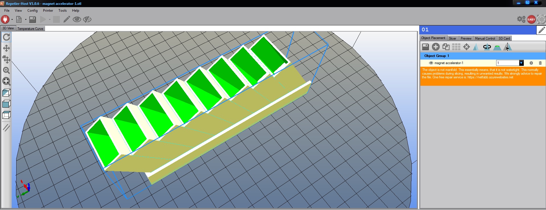

ok i created something in sketch-up 2015 and the model looks great when i'm getting ready to print it in matter control...
but as the title to this thread insists "My STL created in sketch up '15 is starts out good, but then" ugh what a pain in the walnuts!!!
well i don't think its matter-control per-say but im still new to this...although i gotta say so far i put almost 200 hours on my rostock max version 2 and even with having to do minor re-calibrations now and then its still kickin ass!
the only time i really have a problem is when i am printing something that i created...usually its a fix in sketch-up, something simple like forgetting to group everything or forgetting to intersect all the lines but this is weird cuz its started to fill in a spot that should be empty and the model in mattercontrol doesnt show anything in that spot as well...
any ideas anyone?

It's printing where a hole it's supposed to be? That seems like an open object issue.
Post the STL if you can.

I opened it up in Repetier. you need to flip the faces inside the channels to start. just select your whole model and normalize faces.

how do you figure
so in sketch up i need to just normalize the faces and thats it...
i wish i could upload a pic so that the problem could be seen
thanks.

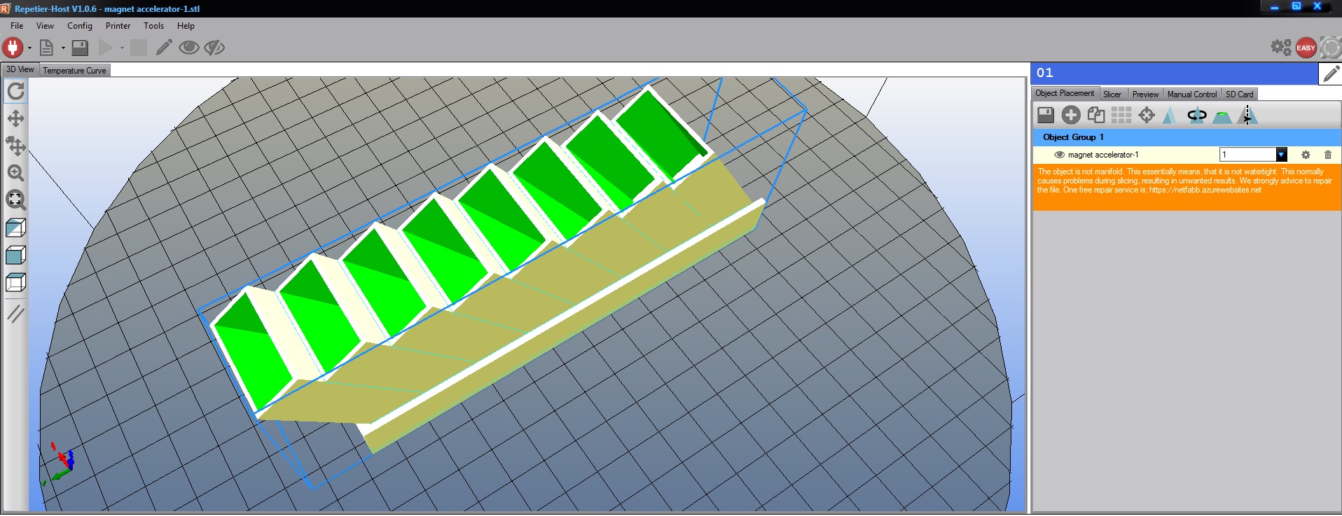

because of how sketchup handles materials, it has a front and rear face. if there are any rear faces showing it can screw up the print. Repetier warns you of this
Green areas need to be flipped
Re: My STL created in sketch up '15 is starts out good, but
You could probably repair it in NetFabb. It says there are 26 shells and 29 holes, so it's not manifold as is.
Try this instead.

ok so i reversed faces and regrouped and exported...so please if you would let me know what it says in repetier if you would please...

Just use Jim's copy above. As for your copy, you reversed all the faces and now all the good ones are flipped. Here's a Tip. When your in sketchup, turn off textures so you only see the default white surface. If you rotate around your model, the bad faces will show up as light gray/violet color. I do most of my work in sketchup as well, and I've had to learn all the oddities. Also for future reference, don't have two solids meet at only one edge. You did this at the bottom where the channels meet the base, and that was likely one of the things throwing it off. it's a problem unique to how sketchup handles its exporting.
