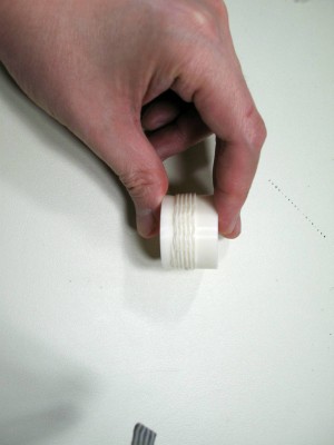

I am having problems printing threads (like on a bolt). It just doesn't come out right. The threads come out blobby. I'm using kisslicer.
8 loops (4mm skin), 0.2mm layer thickness, 0.5 mm nozzle. Infill set at 33% (but it never infills anyways because the loops and skin thickness takes care of it). I've tried a bunch of settings and it just doesn't come out right no matter what I do.

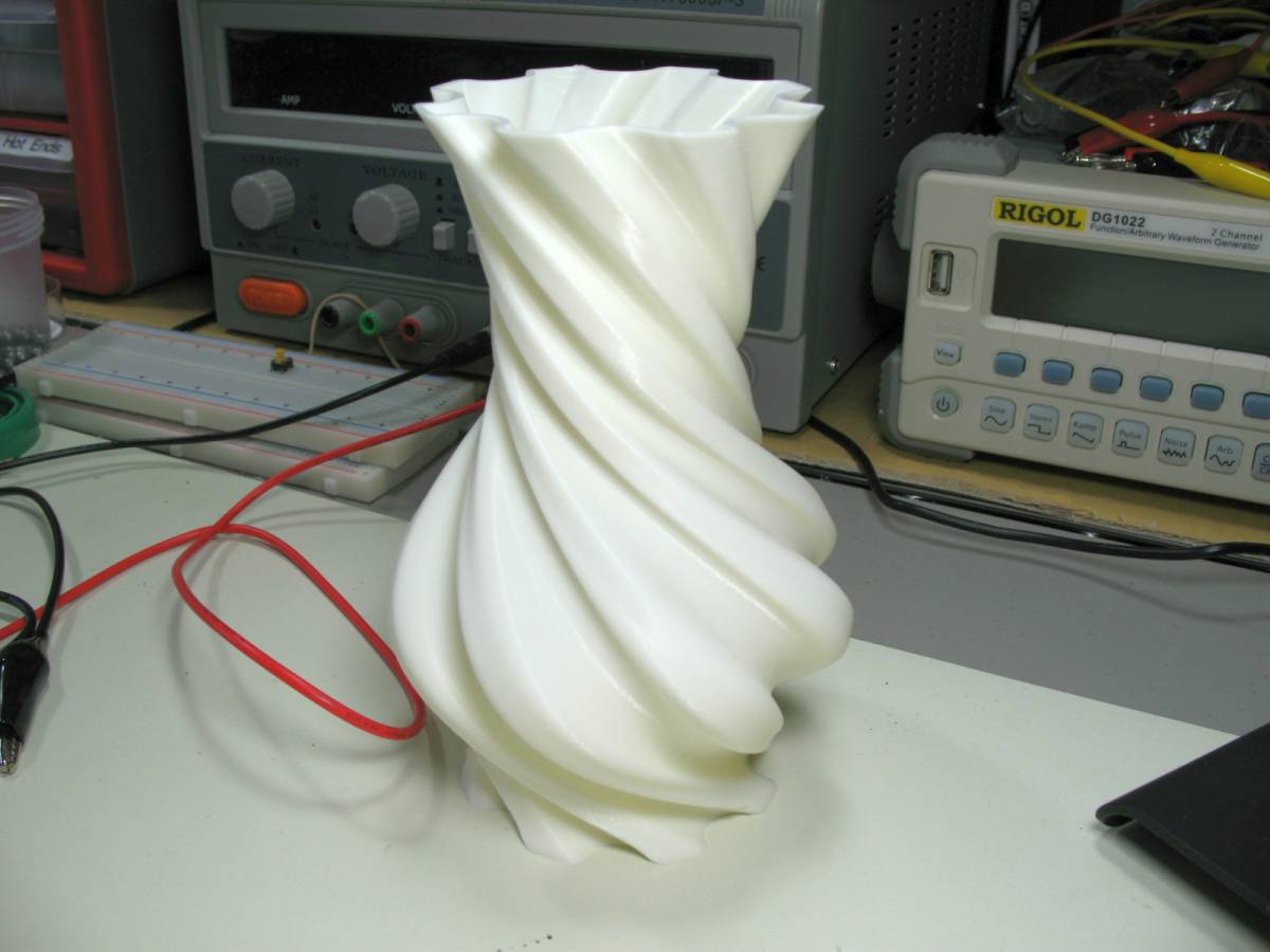

Everything else I print comes out great. The twisted vase looks incredible. I just can't seem to print threads for some reason. anyone have any experience with this?

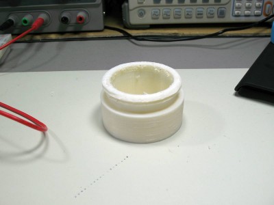

Ok here's the pictures. I think you guys may be right. It's over extruding on the threads.
So this is a print from the same printer. No changes except to the slicer settings. The inside is just as clean as the outside. A little acetone vapor and it would look like it was injection molded.
Here's the frustrating parts.
It's gets all blobby on the inside and the threads are blobby. Not only that the printer is doing some sort of circular fill in the wall. It does these little circles inside the walls of the cylinder. I've never seen it do that before. So it makes the wall layers uneven layer wise.

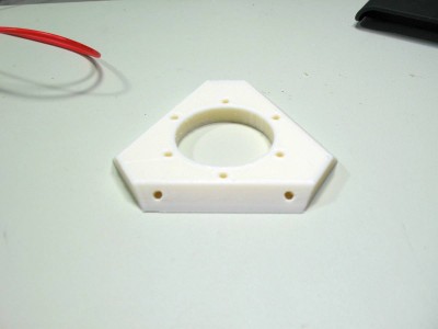

Here are some prints of the Xnaron mag arm parts for comparison. Again no changes to the printer extrusion settings, just the slicer loops, skin width, etc.
Here are more thread type prints. You can see the size in comparison with my hand. These are a little bigger than the one above so theoretically it should be better or easier. I went from 4 loops to 8 loops to 10 loops and it doesn't seem to help.
So I can't seem to figure out the settings. I will check the extrusion and the size of the filament but it has been very even. The only trouble I have had is with the threads. Everything else comes out great.

The vase was printed using vase setting in Kisslicer. The others were not 100% infill. They vary from 33% to 75%. It doesn't seem to matter. I'm curious what settings you guys use for your slicer to do threads.
