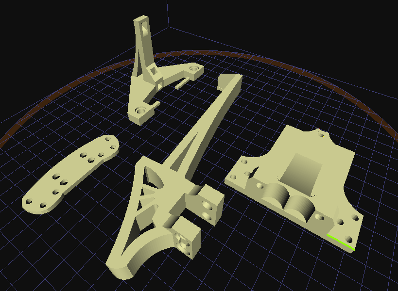

I've been developing lots of mods for the MAX Metal, as well as redoing my old mods to work with it. Since you asked, this is the first I'll release. http://www.thingiverse.com/thing:1000936lyncos79 wrote:I should receive my Metal Max Platform next week to finally get a full Metal Max build... I was wondering if anyone has been able to fit a Z-probe limit switch (should be the same on original platform) on this Kind of build ?
- bvandiepenbos
 - Posts: 923
 - Location: Goshen, IN
Thanks for sharing 626Pilot626Pilot wrote:I've been developing lots of mods for the MAX Metal, as well as redoing my old mods to work with it. Since you asked, this is the first I'll release. http://www.thingiverse.com/thing:1000936lyncos79 wrote:I should receive my Metal Max Platform next week to finally get a full Metal Max build... I was wondering if anyone has been able to fit a Z-probe limit switch (should be the same on original platform) on this Kind of build ?
I am looking forward to seeing other cool things you design for the MAX METAL Frame.

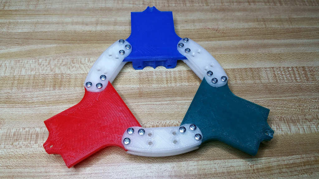

That's my new filament spool holder, and an early prototype for a flying triple extruder mod. This is inspired by your Fly-N-Strude, and the one it's based on (I forget who did it - dude had an entire giant Rostock v1 geared extruder hanging from elastic). It's intended to replace my arm-mounted extruder mod, and is specifically intended to support the new 3-in-1-out Diamond hot end. The extruder platforms are long enough to support putting the EZStruder on a geared motor.bvandiepenbos wrote:Thanks for sharing 626Pilot
Like the Fly-N-Strude, parachute cord suspends the extruder platform from the carriages. In order to avoid overtaxing the axis motors (and also to avoid the hot end falling & shattering the glass if you power down the printer when it's homed), suspension masts are mounted to the top rails. (That's similar to the solution the previous guy used.) They project 50mm inward from the rails, and parachute cord descends from them to the holes in the white crossmembers in the extruder platform. That takes up some of the load, and should help to keep the extruder platform better stabilized - we'll see. The tangs on the base of the suspension mast are meant to help align it perfectly with a spool holder.
I also redesigned my filament spool holder to bolt onto your frame, pointed in or out, with a 5-degree incline so that the spool will tend to "fall" towards the edge of the printer. It has to be pointed out if you're using the flying extruder masts. This design has a "less fat" cantilevered design, allowing it to hold Hatchbox and other filament spools with super narrow "donut holes." (Still doesn't hold a T-Glase spool, but it will before I upload it to Thingiverse.)
From now on, any mods I design that have to take the frame into account (like spool holders) will be designed for the MAX METAL. I design for #10-32 x 1/2 screws and the roll-in tee nuts from EBay. This is a fantastic frame, and I hope I can help motivate more people to buy them.

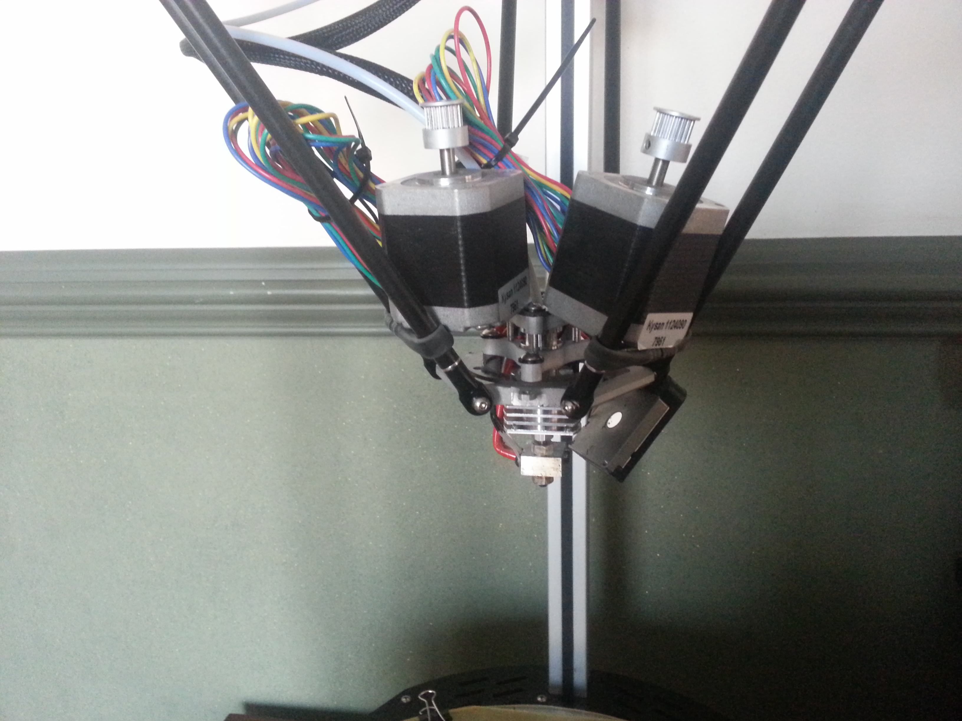

wow 626Pilot, that's kinda sad - for about a month, inspired by your arm-mounted extruder mod, I has been worked on own version of it with some nice 120g geared motors626Pilot wrote:It's intended to replace my arm-mounted extruder mod, and is specifically intended to support the new 3-in-1-out Diamond hot end.
3D printing is magic!
It is very difficult to set up arm-mounted extruders in a way that minimizes friction through the Bowden tube. I had developed mounts that were angled out 15 and 25 degrees (depending on whether you were using a one- or two-nozzle E3D) and that definitely helped a lot, but the less straight the filament path is - the more bends it has to go around in the tube - the more friction you get. That's hard on retraction, and the whole point of this is to make retraction better by straightening the path. I find myself having to move the motors up or down the arms depending on whether the footprint of the print is large or small, in order to minimize friction without the PTFE getting yanked horribly because the platform is traveling too far from the center. They'd have to be mounted on some kind of universal joint to really work the best way possible - or, the entire weight of the motor would have to rest on one arm rather than two, so it would always be pointed straight at the effector. That seemed like a great recipe for causing flexion on three of the printer's six arms, and that flexion would screw up the positional accuracy.Renha wrote:wow 626Pilot, that's kinda sad - for about a month, inspired by your arm-mounted extruder mod, I has been worked on own version of it with some nice 120g geared motorsIs arm-mounting so bad?
Also, when I upgraded to the MAX Metal, I got 0.9-degree steppers. They don't have as much holding torque, and the weight of the motors on the arms was enough that the effector would drop when the power is turned off. This is dangeous - it's more than heavy enough to spiderweb the glass, if it falls from high enough! I just got finished stringing everything up, the printer is off, and the effector is hanging a few inches above the surface.
The person who did the first hanging extruder mod had to run the elastic up and down between the top of the printer and the extruder several times. This was necessary to get the tension right. Now that I see how the upper suspension performs in practice, I think it may be necessary to do something similar. It pulls too much when the effector is very low and near the edge. Another option might be to run the parachute cord from the masts to the carriages, "lightening" them directly and then letting them take the load of the platform in its entirety. However, I was hoping that the use of the overhead masts would help to stabilize the platform and stop it from wobbling or falling to one side - which it does.
There are more ways of stringing this up than I have explored yet. Maybe I'll find a better way.
- Renha
 - Posts: 280
Okay, maybe I should wait for your results. But, look at that beauty: http://www.omc-stepperonline.com/gear-r ... p-133.html, it's weight and torque.
.9 degree steppers on 16t pulleys with two stock 1.8 nema 17 steppers sitting on the effector, without it falling.  I tried three, but that definitely slides down. And yes the power is off.
The 0.9-degree steppers I got from tridprinting.com could hold the effector with the power off, but only the effector. As soon as I had the hot end mounted, it fell on its own. Extruders mounted on two arms was enough to make it fall precipitously.KAS wrote:.9 degree steppers on 16t pulleys with two stock 1.8 nema 17 steppers sitting on the effector, without it falling. I tried three, but that definitely slides down. And yes the power is off.
