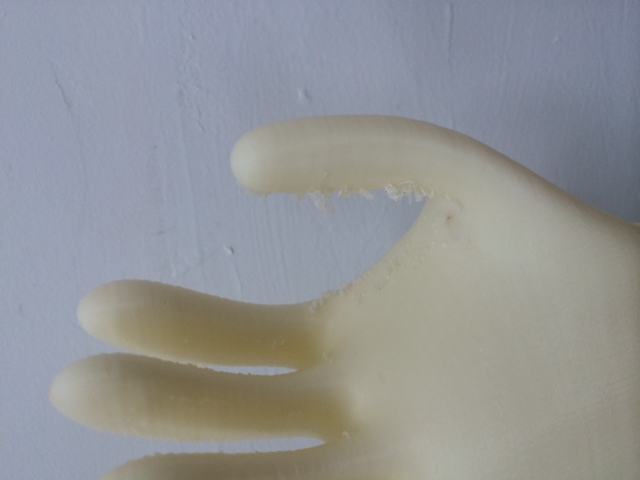

   12hrs printing and print out is nice but it had to shut down.
  12hrs printing and print out is nice but it had to shut down.Some details/observations I like to share;
1. The print size is big actually; 1200 layers, expected print time 19hrs.
2. Hot end and hot bed temperature maintained and did not come down though. (maybe can have a heating max time, where beyond this the heating will stop. Need to save this in Eeprom) Otherwise as in this case heating will go indefinitely!!!. Not good and not safe.
2. Print stopped at approx line 800 - 820. Traced back by going to the line number and looking at the 2D view. Here I found something interesting.
When I tried to view in 3D at line number more than 800, MATTERControl shut down. There was no issue when viewed in 2D view. I could all the way to line 1200. Maybe that was the problem, when the printing reached to that line number. MC crashed when trying to refresh the 3D view. I will try again but this time keeping the view to 2D.
Feedback from SEEMECNC much appreciated. Print out until height 210mm was fine.
