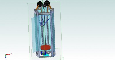

Hi all,
So after plenty of time with my two delta printers (RostockMAX v1 and SpiderBot) I felt the need for a bigger one. Having designed my own replacements parts for most of the machine (other than the frame) I decided to go for my own design from scratch because its more fun that way. My goals were big, rigid, accurate with a chamber, and not too crazy expensive, or heavy on custom manufacturing. I like 8020 but didn't know of good options for 60 degree corners until I found 40-4096... At this size I don't trust plastic vertices.
So after many evenings playing around with a design I have something close to what I will eventually build... looking for input here...
v1.0.pdf
(1.71 MiB) Downloaded 483 times
(3d pdf)
So here are the specs:
- 400mm round build surface
~ 870mm build hight
- Water cooled triple hot ends
- Chamber using polycarbonate multi-wall
Components of interest/concern:
- Heated build surface, current plan is to put power resistors on a 0.25" aluminum plate, didn't find any good/cheap options at this size
- V-rail 1500mm length, never used
- Common GT2 belt (5mm wide?) should I go bigger for such long lengths?
- My triple water cooled hot end (http://forum.seemecnc.com/viewtopic.php ... 454#p56454)
- igus ball ends, I haven't used them before
- Chamber walls fit in 8020, using polycarbonate multi-wall from HomeDepot, I wanna avoid getting parts laser cut
- Megatronics v3 (I like thermocouples)
- Updated version of my extruder (https://www.youmagine.com/designs/nema2 ... e-extruder)
And of course how much will it cost? $2270 I hope to get the price down by ordering the 80/20 from a distributor and not buying it on their ebay site.
BOM.xlsx
(15.66 KiB) Downloaded 633 times
Still a few details left but feel I am getting close

That looks incredible!

As for the question regarding the belt, my Max has a height of 815mm, and the 5mm belt is fine with it, produces very accurate dimensions even after some 700 hours printing. I think it would be highly reliant on the mass of your end effector, that triple water cooled hot end can't be light is my thinking.

Durandal: Thanks for confirming about the belts, I haven't had any issues with mine but my SpiderBot has really wide belts and is smaller than the MAX. It is much more rigid than the MAX so I am wondering if wider belts would remove a little slop. While everyone sees my water block as heavy it really isn't that bad...

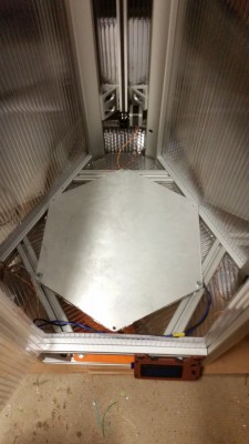

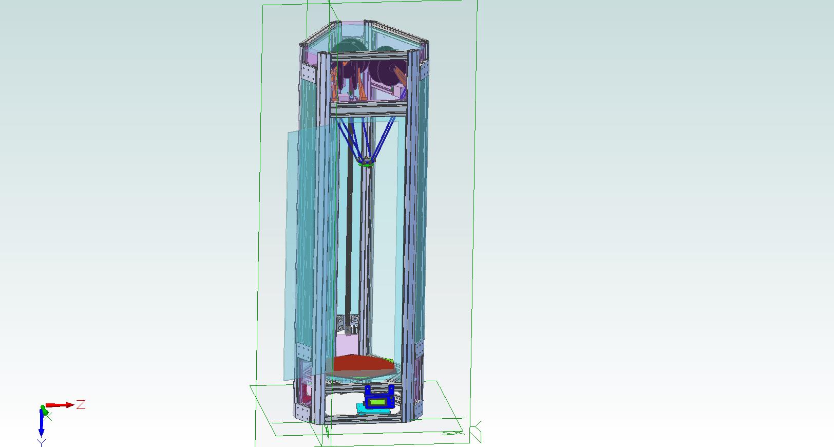

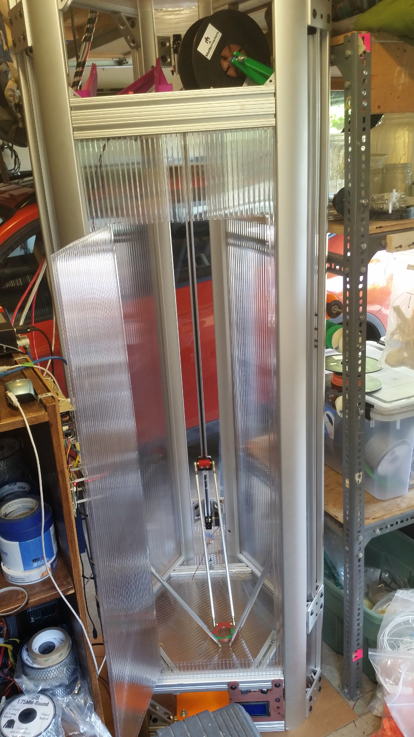

Well its been 9 months and I have finally gotten through the majority of the build.
I made a few improvements:
- Re-did the bottom to be simpler and have the bed leveling screws in line with the vertical axes
- Extended the chamber to above the filament to hopefully help keep it more dry
- Adjusted the location of the axes to get more build space
The cost with 95% of the parts included is at $2300 (but involves a decent amount of labor to make some of the special parts)
It is coming along pretty well and looks good (if you like that 80's robocop look;)
v1.1.pdf
(1.46 MiB) Downloaded 558 times

Post by stonewater »
your vertical supports... what are they called and where did you get them? looks like pairing them on each corner has given you the angles you need.

They are 80-20 4096 extrusions, I think they are fairly new at least when I started the design. They are only in the metric 40mm size but I found the 40 size is close enough to the 15 series (1.5") which I had some of. they are also nice to use since they have a number of internal channels which help with wire management and electrical shielding from each other, though I haven't' gotten to wiring it all up yet.

With the exception of the openbuilds v-rails the structure is all 8020 and so far seems very rigid more event then the much smaller spiderbot I have.

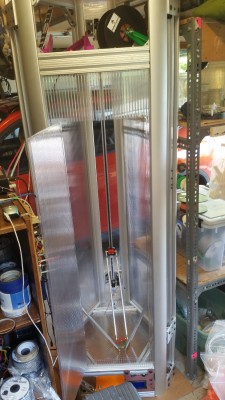

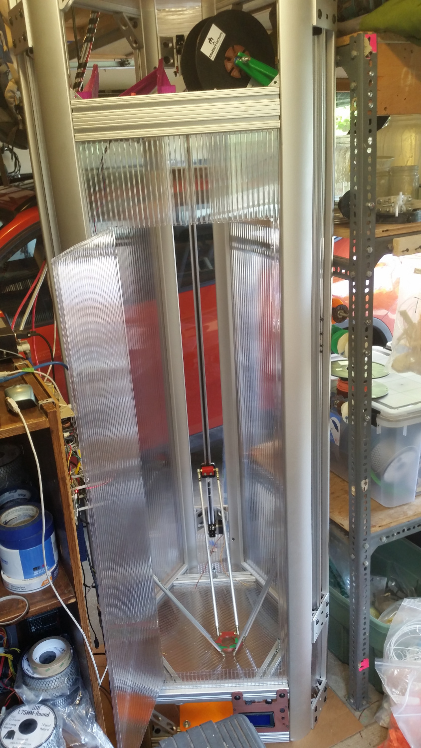

So I am almost done with the build, lots of little details that took quite some time, and wiring has proved to be rather tedious, I wish I had routed wires down the extrusions earlier...
Anyways I am currently stuck on one electronics issue.
I am running a RADDS on arduinio DUE and I keep blowing the 10A fuse (non-heat bed fuse).
After looking at my loads I am wondering how my other printers which use megatronics and apparently have a 7A capacity, don't also blow their fuses.
So here are my loads, all on the 10A fuse:
3 - 40W heaters (~3A each) 9A total!
3 - NEMA17 axis stepper motors (from ancient MB cupcake) measured ~6 Ohms/coil (~2A max) or 6A total
3 - NEMA23 extruder steppers measured ~2 Ohms/coil (6A max) or 18A total
Now I know the steppers don't pull that much as they are driven by DRV8825 pololu drivers which can supply 1.5-2A each.
So during testing if I hit home so the axis steppers are on: ~4.5A then turn on all the hot ends at the same time (+9A) the fuse blows 13.5A>10A
So 2 questions:
1. Is the 10A fuse too low and how safe would it be to put a 15A fuse in instead? Would I fry some traces?
2. How has this not happened on my other machines (with megatronics boards)? I have definitely had the axes steppers and all extruder heaters on at the same time and no fuse blown.
I don't have part numbers for the little NEMA17 motors but from an online forum they supposedly have 35 Ohms/coil yet I measure much lower resistance.
mikefazz
Posts: 31
Joined: Mon Nov 18, 2013 12:45 am
Location: Seattle WA
Re: RoStockFAZZ
Post by mikefazz »
So for anyone following along the issue was the little NEMA 17 motors. The ones I have: moons type 17hd4063-01n I can't find any documentation that gives its operating voltage but whatever is going on after replacing them I haven't blown a fuse yet. I still don't get how the apparent undersized fuse works but at this point if it works I don't really care. Now onto calibration...

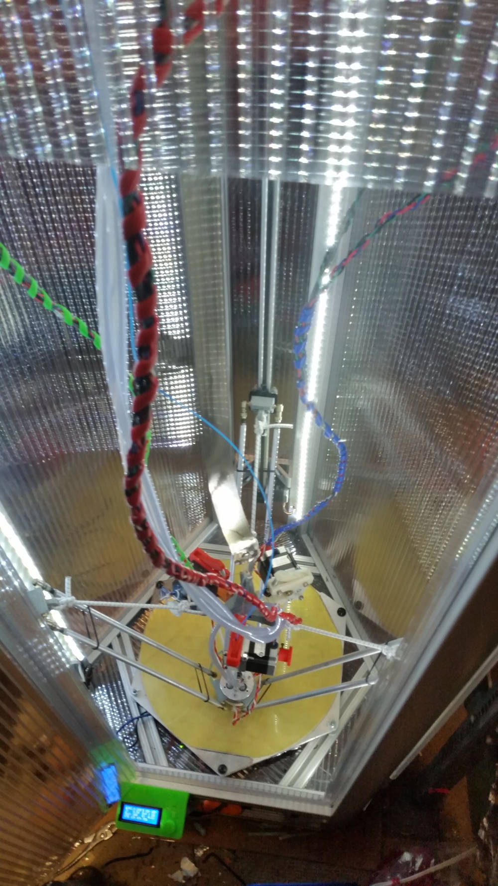

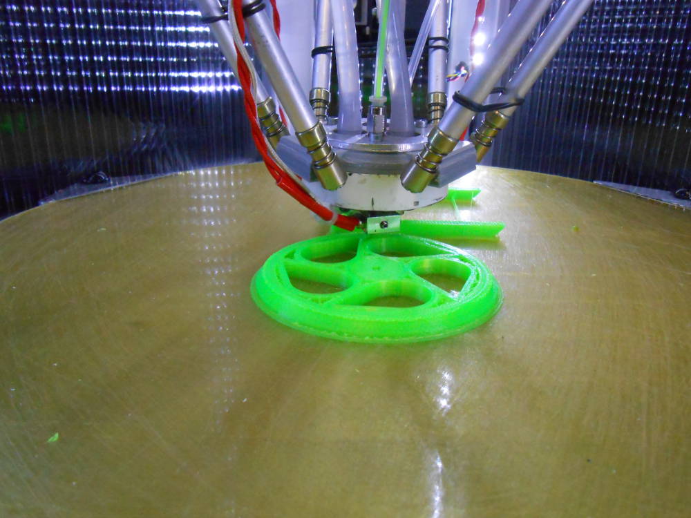

So I am on my first print!
Some new features I haven't mentioned yet:
- RADDS yes I decided to go for a new 32bit controller
- Flying Extruders mostly worries about long bowden tubes, and thought I would give it a try
I did a quick overview video feel free to check it out here:
https://youtu.be/uwi8UBFYH8s
Still have to try out the other extruders and it could use a bit of work getting the wiring neater.
