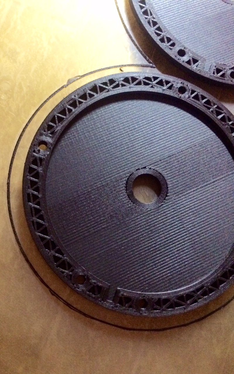

Sorry for the poor photo. These are PP parts I am printing now. The first shell over the grid infill at 50mm/s and 210°C with a .4mm brass nozzle (Kraken hot end). When done, the surface will look excellent.

Here's a better photo showing the type of infill I mean. This is triangular infill from S3D. I think MatterSlicer does this one too.

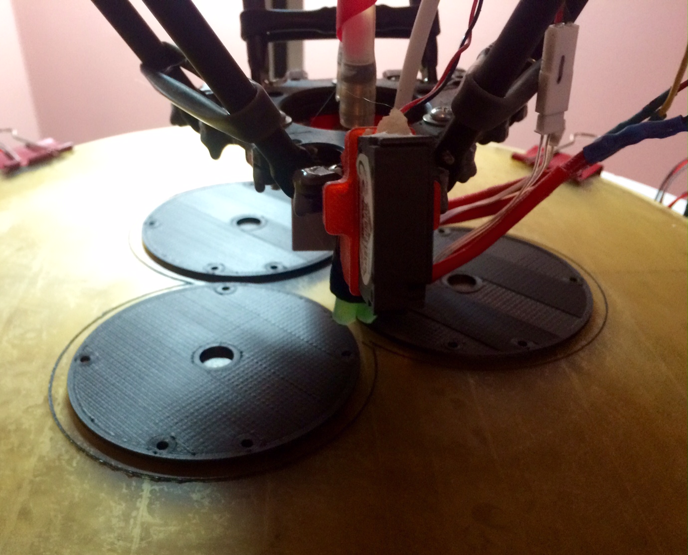

OK - have several test prints done and one pic to share.
On the left is 80mm/s - might actually be slower than that since I had the cooldown parameter set.
On the right is 40mm/s - no other parameters changed. WAY smoother.
We did do a break test on one of these at the 80mm/s speed - fractured cleanly across layers as expected, but marginally strong enough.
I'm hoping the 40mm/s one is noticeably stronger. Will let you all know
