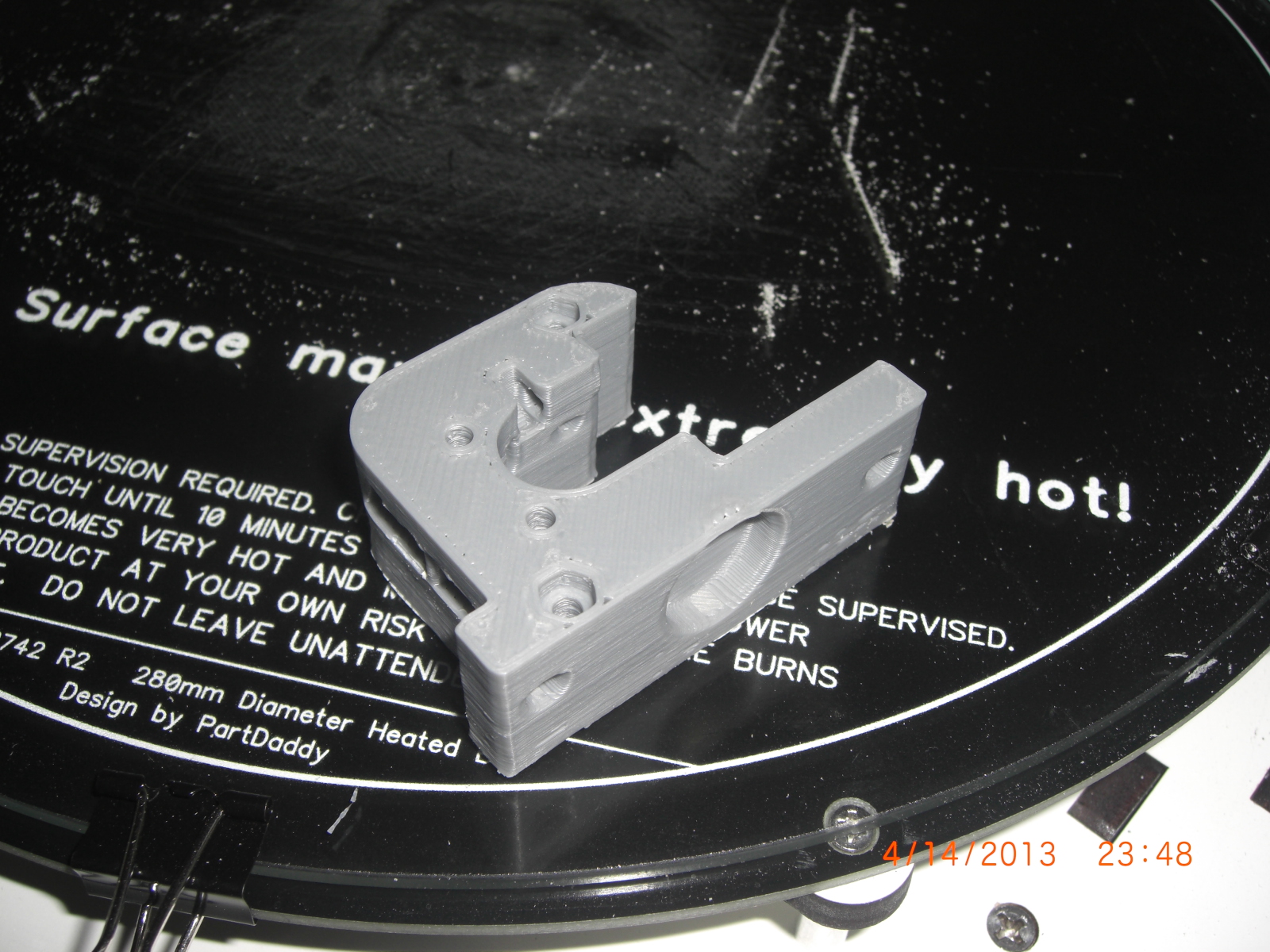

anyone here openscad savy? could take this file http://www.thingiverse.com/thing:43457 and make it so that the mounting ends are on the opposite side.

adapter made.. on my way to tryin this out. unfortunately, i'm not opencad savy. so had to do this for now.

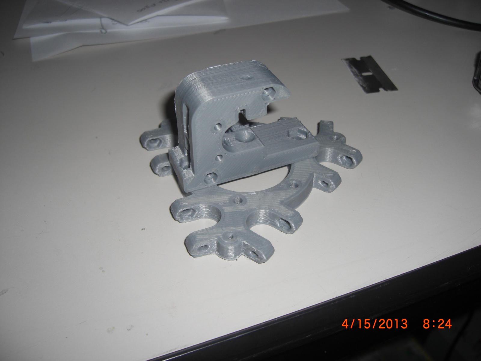

I'm guessing that black circular piece mounts to the platform and looks like the extruder is above the platform, If so you may have issues with it hitting the arms on certain moves. but if its mounted with the spacers like the original it might have enough clearance, now that i think about it.
I had planned to mount it underneath, I will lose z height but I'm compensating by getting longer extrusions. If your mount works better let us know. I won't lose z height and i'll have more z height in the end
also another thing that concerns me is backlash from the extra weight of the extruder, so i'm searching for better belts.

made more progress on this last night after completing the johanns jhead rostock adapter.
