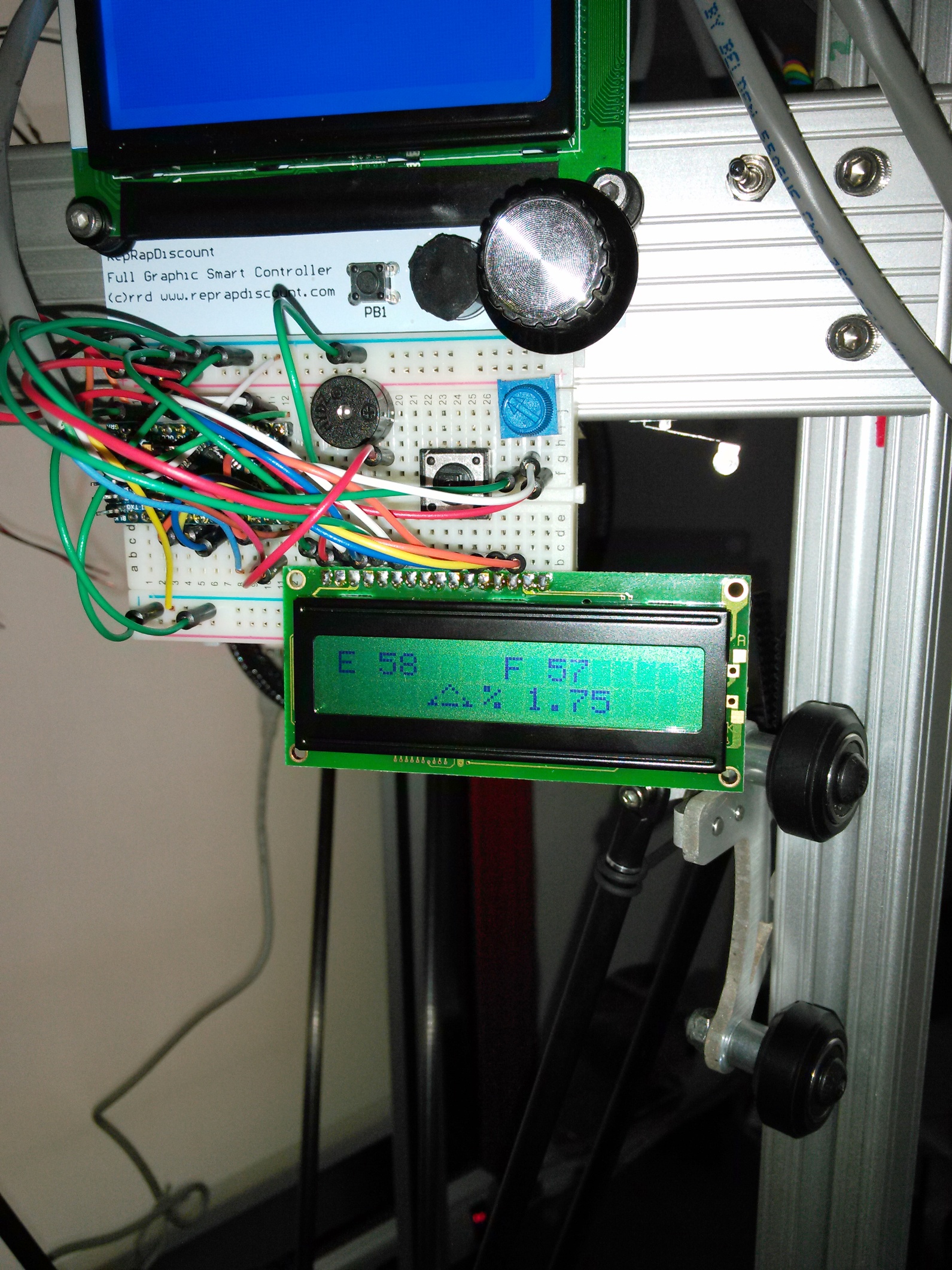

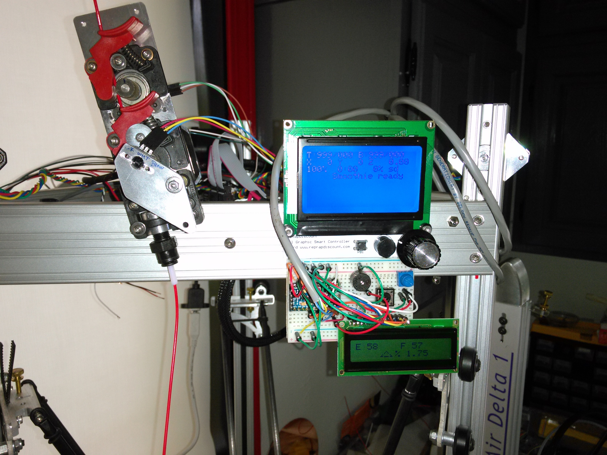

Still rather crude, but it works pretty good.

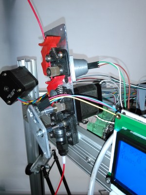

Two encoders, one measures actual filament movement, the other movement of hob drive roller.
Arduino compares two and sounds buzzer if slip is detected or out of filament.
Displays amounts moved and % of "slip"
That is all it does currently. Plan on adding ability for it to stop/pause machine.
Could also measure actual filament movement for calibration purposes or even "auto" adjusting machine speed, etc. on the fly.
Plan on adding sd card to log data from entire print for further analysis.
Should also add a force sensor in bowden tube to measure "back-pressure"... that may be insightful for tuning best print temperature for each filament.
I also built this to test the many different hob designs I have.
