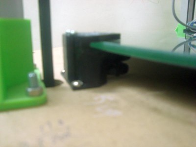

Here is the bed leveller for 310mm SeeMeCNC heat bed and my custom tempered 5mm glass (340mm diameter).

Saw that on Thingiverse... Now if only there was some way to integrate FSR pads...

The only problem with a bed leveler like that is you end up changing the squareness of the bed relative to the towers.

DSteck wrote:The only problem with a bed leveler like that is you end up changing the squareness of the bed relative to the towers.
Actually, I am using Proximity Probe to level the bed with Marlin Auto-calibration function. I auto level my 1st delta printer on which i am printing currently. But still it needs fine tuning. But i don't have this fine-tuning adjuster on its bed. Presently i am leveling the bed with glue stick ;).. I add more glue stick on the shallow areas ...
Once calibrated with auto-calibration, you can then fine tune the bed ( believe me nothing wrong happen) with this bed-adjuster. You no need to auto-calibrate again after manual fine tuning, simply because it will get the same error(deviation) again with auto-calibration.

Jimustanguitar wrote:Saw that on Thingiverse... Now if only there was some way to integrate FSR pads...
I never used FSR, I am using Proximity Probe on effector plate. I can change the 3D model if i know how FSR works and off-course if you need.
