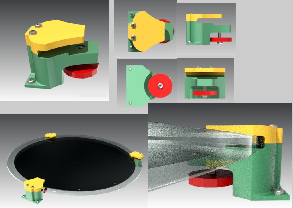

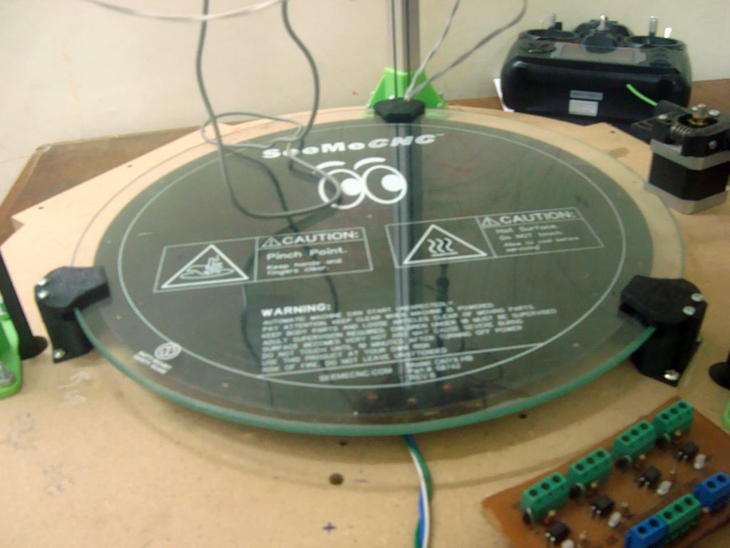

Here is the bed leveller for 310mm SeeMeCNC heat bed and my custom tempered 5mm glass (340mm diameter).

The only problem with a bed leveler like that is you end up changing the squareness of the bed relative to the towers.

Actually, I am using Proximity Probe to level the bed with Marlin Auto-calibration function. I auto level my 1st delta printer on which i am printing currently. But still it needs fine tuning. But i don't have this fine-tuning adjuster on its bed. Presently i am leveling the bed with glue stickDSteck wrote:The only problem with a bed leveler like that is you end up changing the squareness of the bed relative to the towers.
Once calibrated with auto-calibration, you can then fine tune the bed ( believe me nothing wrong happen) with this bed-adjuster. You no need to auto-calibrate again after manual fine tuning, simply because it will get the same error(deviation) again with auto-calibration.
