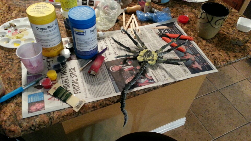

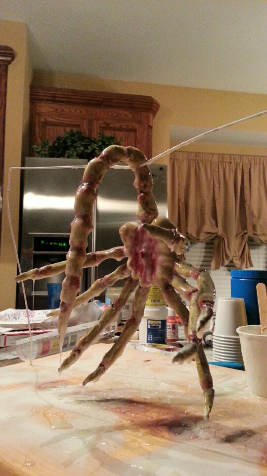

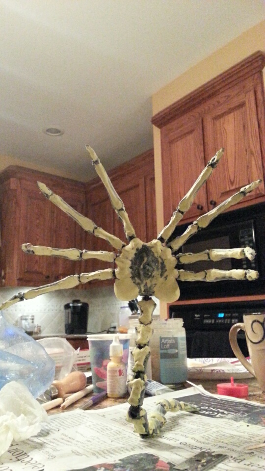

Hello. I spent some time over the weekend making a Alien Facehugger prop. I used one of the models I found on thingiverse and, after several major modifications to it due to incorrect proportions, finger lengths, air sacs, and the missing probiscus, I printed it out in black ABS. I then used yellow Milliputty to build out the details. Each leg is hand wired, painted with acrylics, and then I used Dragon Skin Smoothe-On that I colored (and spending hours moving the silicone back to the right areas as it slowly firmed up). I've got one more coat to do, but I thought you sci-fi fans like me might enjoy my work. Alien is my favorite movie of all time and I always wanted a face hugger to call my own. lol

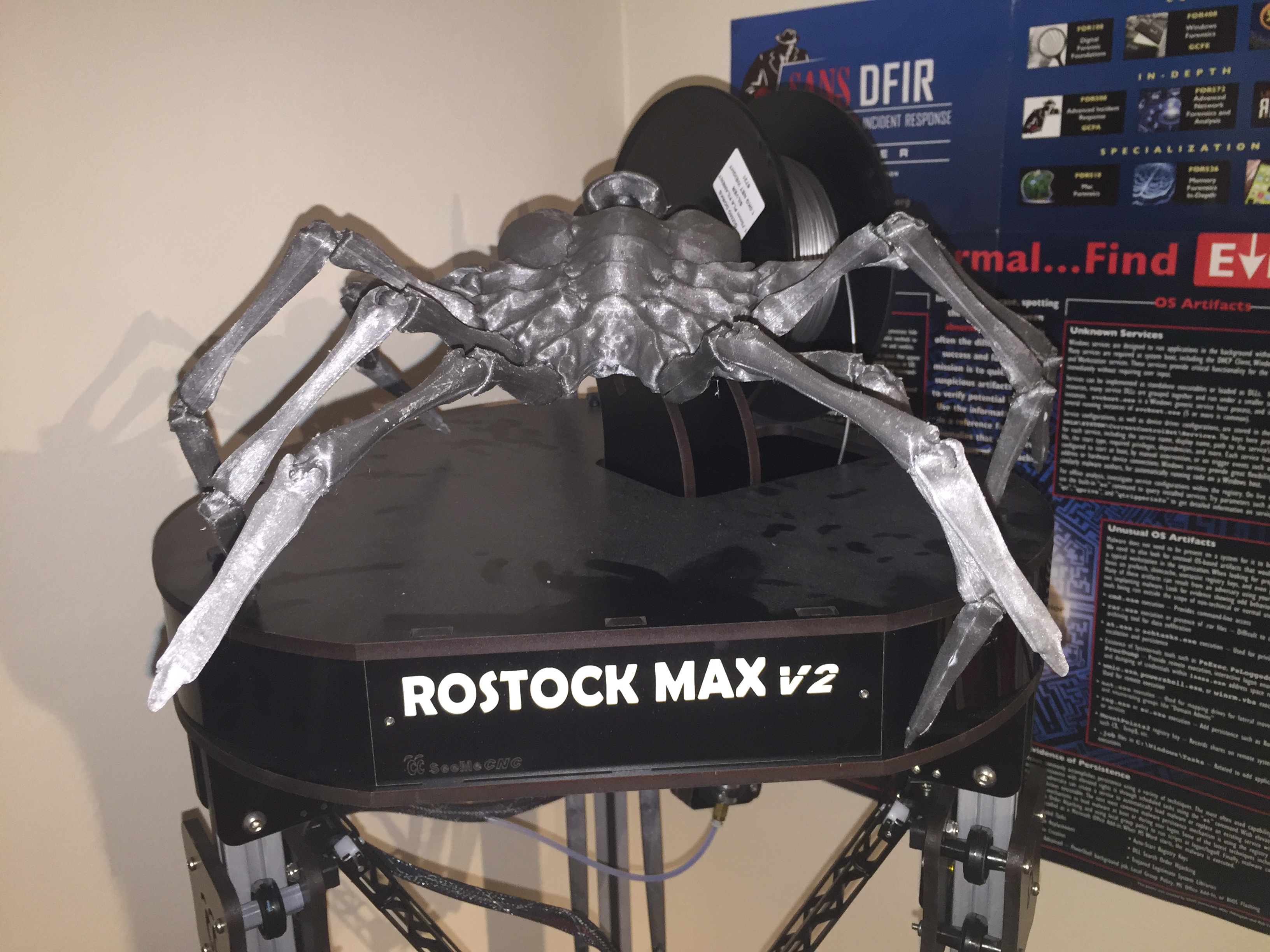

Nice job. Post processing and finishing are what can make 3D print builds final objects. Being able to paint the finished pieces removes the complexity of multi color filaments and careful sanding, heat gun, and primer coating can make prints look fantastic. This is a build that is done in parts and it looks like the joints have ball joint. Being able to flatten it makes support removal easier. The support on the one from thingiverse worked but the amount of support plastic used was just as much as the build, plus that support removal must have been a nightmare.

Yeah, I saw that one as well and though about printing it a before choosing the articulated simple one as a pet project. You are right that the amount of support materials was nuts for that, but it is a beautiful scan he did. The new files I'll be posting have two parts to everything and i've pretty much re-sculpted about 80% of it. No more flat bottoms to the legs and body. It requires some gluing for each half of the body and legs, but you get something a lot more detailed and flowing like the model you posted above, but without the supports and it will be able to be posed. Mostly spending time right now making sure the joints are not only strong, but very tight. Unfortunately, I've been fighting with a stupid speck of dust in my nozzle that I finally was able to dislodge after losing about 5 attempts to print a leg. Frustrating, but now I have a good system to get rid of the dirt clogging the nozzles! seems to happen mostly when I change from PLA to ABS. I wonder if the very high temperature of ABS causes some small pieces of PLA to burn so bad they turn hard in the nozzle and then clog it up. Not sure though.
