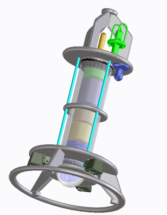

oh no now you got me started!, The sub is almost an ROV,  it is a drop camera that may be upgraded to an rov in the future by adding (4) BlueRobotics thrusters.  It uses a 4.5" O.D. acrylic tube and dome housing  by BlueRobotics.  The tube is oriented vertically with the dome facing downward. The p/t cam looks out the dome with lighting mounted external to the tube while another pan camera looks out the side of the tube ( possibly a hacked GoPro 3 which can supply  live video as well as take high res clips and stills).  The subsea end runs off a battery pack and has basic sensors (depth, compass, temp, etc ) as well as a sensitive hydrophone to hear marine life, mainly whales.  Everything subsea is run by an arduino Mega 2560 and custom shield.  Control and telemetry is over RS-485.   A modified Cat5 cable is the tether with one twisted pair each for video, hydrophone and rs-485 plus ground.  Topside is another arduino mega and uno for control via a game controller and all data on a video overlay screen.  The Orion 3d printer is invaluable in the project and i plan on making more parts using it.  As well a a local fellow who has a cnc router to make the drop cam framework out of plastic sheet.  All this is for a local non-profit Marine Science Center to use in their program with youth and adults offshore on a boat,  so far they can only see and hear whats happening on the surface with the drop camera they can get a peek underwater , at least up to 250 ft deep.

here is a cad rendering of vehicle with frame and payload less lights and a few sensors

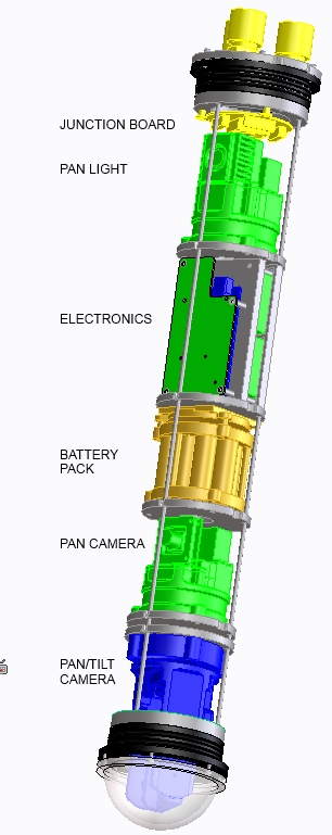

Have lengthed housing tube from picture to accomodate all stuff it is now 24 inches long 4.5 inches diameter.

the drop camera has two ntsc video cameras at this point. one is mounted on a pan tilt platfom facing downward with fixed lighting, the other camera is facing out of the tube housing horizontally and pans only, the led light is mounted on a similar pan platfom about 12 to 14 inches above the pan camera, it pans in sync with the video camera. both led light and camera have continuous pan capabilty with an position feedback sensor on both so they can sync movement.  the led light is a cree model and can output up to approx 3600 lumens.  I want to minimize backscatter into the camera thus the reason for placeing the camera an light as far apart as possible.

here is updated dropcam design with recently 3d printed parts.  have be using t-glase and recently esun petg for material with very good results.
have printed parts with upto 90% infill (top and bottom rings on rail mount) for very strong parts. Things i would use to make out of HDPE sheet
now i just print, much easier to let the printer do the work!
