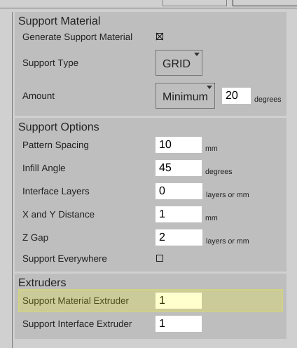

I'm trying to print something with grid support and everything sounds and looks okay for the actual object but when it prints the support material, it seems to drag on the top layer. Most noticeable is the sound but it looks like it's dragging slightly. Is there a setting that causes this? The support is printed at the same speed as the infill so I know it's not a speed issue.
ABS
235 C
60 mm/s for support & infill
30 mm/s for perimeter
Grid Support is dragging

This is the Mattercontrol Inbuilt slicer626Pilot wrote:What slicer is this?
Re: Grid Support is dragging
Never used it, but if it's like Cura, it will make a grid for internal support, and - stupidly - cross its own lines while it does so. That behavior convinced me to abandon Cura immediately. I would hear it going bump, bump, bump as the head ran into filament it had just freshly extruded. The bumps built up layer after layer, and if I didn't make the skin thick enough, they would carry all the way up to the surface. A really bad algorithm, IMO.
