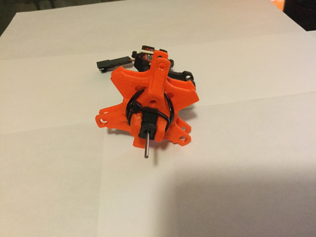

I want to start off by saying Thank You to 626Pilot for all the work that you have done for the Smoothieboard. Your firmware is the reason that I decided to purchase a smoothieboard, and possibly why I have used my printer so much since installing it (I was having the hardest time using the Rambo and Repetier to print all over the bed making me not want it any longer.)
A little background on my setup. I bought a RSMv2 in February and had a blast with the build. Printing started off well with the Fan Shrouds, and also with a few smaller prints about the size of the shrouds. But when I started to try and print larger objects, I noticed that I was having high spots between the towers. I was able to get a good calibration once by shimming the bed, and messing with the tower rotation. But it led to other problems with dimensions, and after cleaning the glass one day, I could not get it back to where it was once I put the glass back on.
So I decided to give 626Pilot's firmware for the smoothieboard a go. I purchased everything to make 626Pilot's Hall-O Probe (Did the best I could printing the parts) and installed the Smoothieboard. After a couple attempts calibrating the probe, adjusting the speeds, I did a full calibration and was very satisfied the first time around. I was getting energies around .070-.100, but I did feel that the calibration had the potential to be much better. Time to Upgrade.
Right around this time was when Brian released the Max Metal Platform. I purchased the Platform, some Trick Trucks, 325mm CF Arms, 0.9 degree steppers, and a Prometheus. After Making these upgrades I have been getting great calibrations since.
It is very sad to see the troubles you have been going through with the smoothieboard and even more sad to see you leave to another platform, but I will say, I'll follow you to the next device because your Heuristic Calibration has been amazing and kept me interested in my printer. This post is my attempt to hopefully get you to keep updating your Smoothieware fork in the future :D
So thank you for what you have put into the Smoothieboard, and for this community here. It is really appreciated!!
Below is the output of my last calibration using the build from 6/12/2015.

For my Probe, I have been using 626Pilot Hall-O with a modified Top and Bottom that matches the 3 main mounting holes
I have also "Flipped" the magnets so that they push away from each other. I feel that this keeps the rod more steady, and also makes sure that the rod doesn't get pulled up and you end up crashing the probe during calibration.

EskimoRuler wrote:For my Probe, I have been using 626Pilot Hall-O with a modified Top and Bottom that matches the 3 main mounting holes
Nice work! You should publish it to Thingiverse as a remix if you haven't already.

Post by WZ9V »
Got it working it as I suspected my FSR setup is long n repeatable measurements. Using DC42's IR probe I got better numbers but since it's offset so far from the hot end. I need to figure out how to make the probing radius/grid smaller to keep it on the plate.
WZ9V
Posts: 65
Joined: Sat Jan 25, 2014 8:49 pm
Re: Heuristic (AI) calibration for delta printers on Smoothi
Post by WZ9V »
626Pilot, does you calibration set the maximum Z-Height or do you still need to do that separately like with the stock algorithm?
