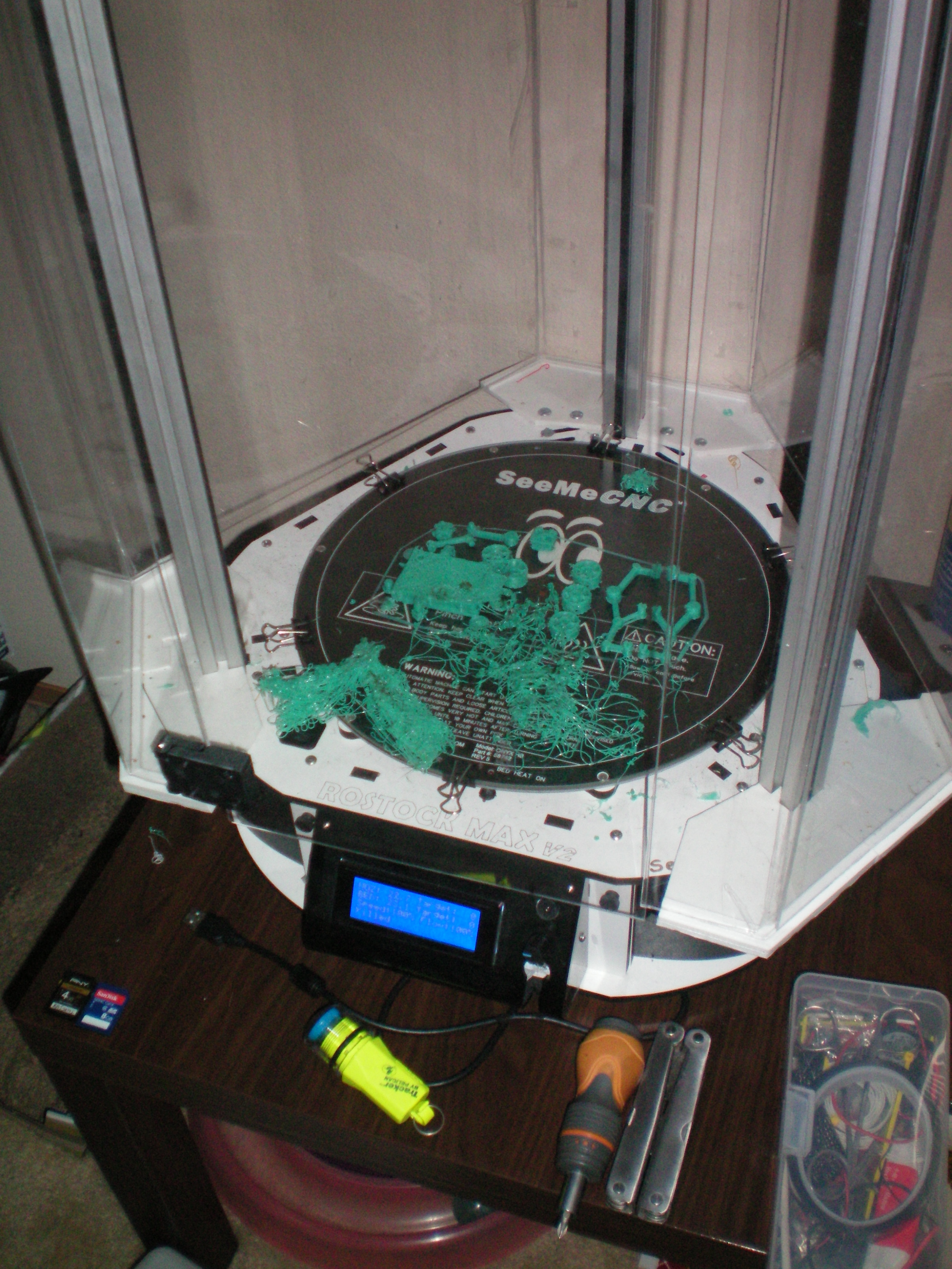

ok so i tried to print benchy the printer bench test a couple of times with no luck again and again after a few hours it turns off. completely shuts down with no voltage anywhere, i cruised the forums and found this problem has already happened to others so i am assuming now i need a new power supply. could somebody verify this just for my reference before i spend some more hundreds and still cannot print what i want.

Re: printer leveling
Post by teoman »
You may want to check the switch on the rostock. I found it wanting to come loose once.
Or excessive heat down below might also cause it to ahut down.

Post by gaexcalibur »
I have added a fan to the case to remove heat and the room is cold so heat is not a problem here and so far no loose connections
ok another extensive week of testing, work and failure. i am pretty sure the power supply is not up to snuff as the components wear it cuts out to protect itself as it is too close to the power supply limits when everything is running for as many hours as i have run so i give up. for sale one rostock max v2 with several spools of filament in need of a power supply 1200. no shipping unless you are willing to pay for packing and shipping the bloody thing. i live in washington state. i will get a printer that is simplier and of a more proven design because this is not working and has not been working for far too long. it has been a pain in my backside and now i can get two others for the price of this one. good luck with yours
Or you could..I dunno, try a new power supply? Crazy, I know.
What gets my goat is the fact that you've obviously identified the problem, but would rather sell the machine than go to the minimal effort to solve the problem.
I mean c'mon. You unplug the power supply from the RAMBo, take the four nylon screws out of the back and the power supply will drop out the hole in the bottom. Hit Fry's and get a new power supply and go.
Sometimes the power supplies that ship with the kits are dodgy. Considering how many kits have been shipped, the number of genuinely bad power supplies is pretty small. You may have gotten unlucky. Have you contacted support about it?

ok gene i wasted $100 on a new power supply spent an entire weekend intalling it, leveled the bed spending 4 hours just to make sure it is prefectly level, all towers square everything is as good as it gets. i did one single print as a test and it worked. so the next day i try to print a larger object, start printing what i really want to print only to have the thing smash into the glass chipping out a large chunk. flip the glass over as one side is still ok, relevel the bed again!!! then print, again one successful Benchy printed. without turning it off or resetting i reprogram the part i need to print and again it smashed into the bed destroying the glass. so now i need to order a piece of glass to go with the power supply i just replaced. how come i have to relevel the print bed every time i want to print this should not be this hard once level it should not change it has not moved the same settings are used for my benchy test as my regular print and smash it goes can anybody explain why this printer needs 4 hours of leveling every time you want to print????? i know others do not have this problem so this is insanely stupid why does this printer get awards when you cant make it work??? and the bed was super level i did not take a picture but the test rings came out perfect, benchy came out perfect real print does not work and smashes the glass to bits, 2 different programs two different days with the bed leveled completely as flat as can be.
Posts: 1561
Post by Xenocrates »
Has you tried decreasing the rapid speed in the EEPROM? it may be that the steppers are not able to decelerate the head fast enough, and it's hitting the glass. Also, what beyond benchy have you done to calibrate it? Is benchy something you use the normal slicer for? Have you attempted Z height calibration, or used openDACT at all?
I realize you're quite frustrated, and somewhat understand why, as I had some calibration issues for a short period of time. It would be helpful to get a copy of your EEPROM values, as well as a shot of your slicer's settings, and a picture of the machine itself. Are you using Mattercontrol? Some other host? Printing from the SD card? Which slicer are you using, and is it stand-alone or not?
It may be that the model, or the slicer are dodgy, rather than the printer or calibration. Could you upload either the model, or it's Gcode for us to have a look at.
Please, be calm. The majority of people have few issues with it. You appear to have unluckily hit the jackpot, with a lemon of a stepper and power supply. It's a far better, and cheaper kit, than say the Makerbot Replicator X2, which thanks to an intelligent hotend, does really dumb things and needs said hotend replaced far too often.
But if two prints are perfect, and the third is non-functional, then it is likely the G-code or the print, rather than the printer. It is a machine which is repeatable and accurate. If it is performing properly, then any errors are most likely the result of bad input. There may be an intermittent mechanical issue, which could cause it. It may be your firmware is allowing negative Z values, which would drive the printer into the bed. It might even be thermal expansion, if you were adjusting it cold.
