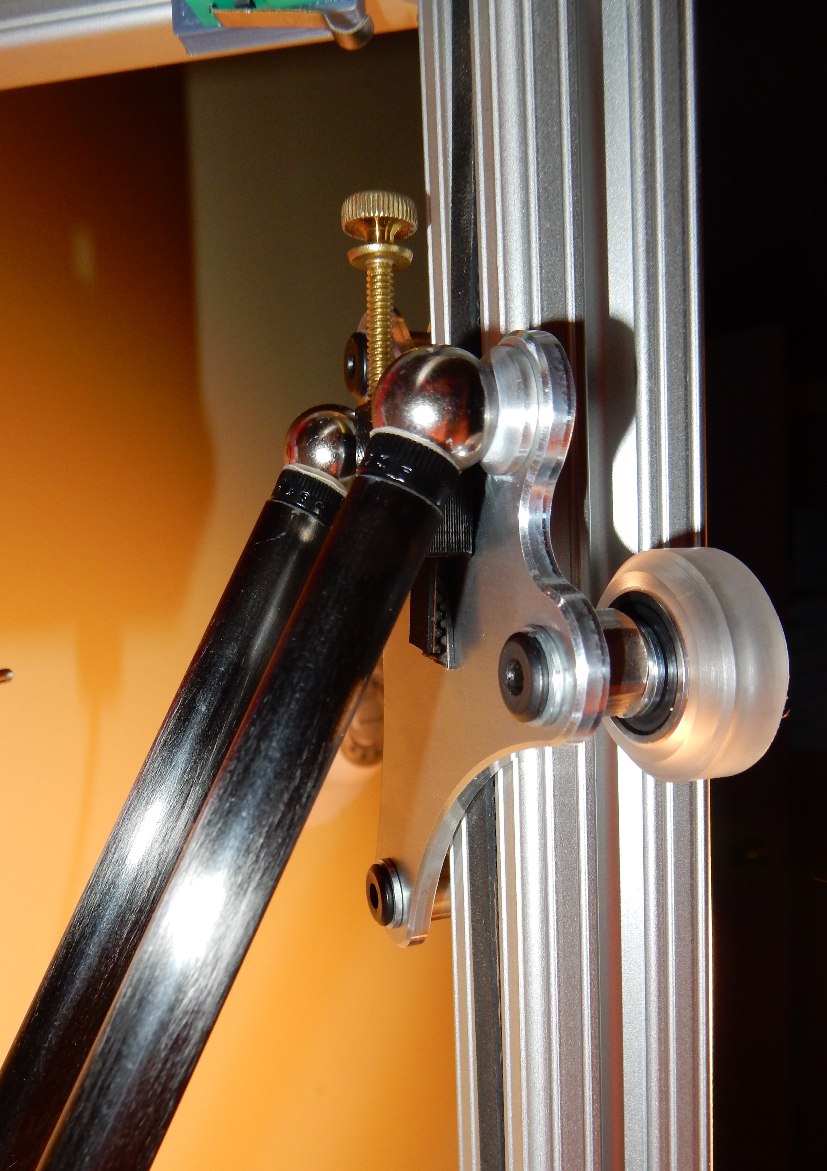

For those who might be interested, in upgrading to the BerryBod magnetic arm system, you can purchase them at:
http://www.shopspt.com/product-p/spt-mzlk.htm
You have two options either to reuse the wheels and hardware from the V2 Max or OpenBuild parts. The upgrade is very well made, and there is a great difference in print quality from magnetic arm and direct extrusion. The magnetic arms are longer and the hot end is mounted under the effector, giving you ability to reach further on the build plate as well. You can also swap your hot end in seconds.
BerryBod Carriages, effector and direct geared extruder.
Re: BerryBod Carriages, effector and direct geared extruder.
You've got the stepper, gearbox, and extruder directly coupled to the effector platform, eh? Are there any 'inertia artifacts' from throwing around that much weight? Are the magnets sufficiently strong to keep that from coming apart during rapid movements?
No inertia artifacts.Jimustanguitar wrote:You've got the stepper, gearbox, and extruder directly coupled to the effector platform, eh? Are there any 'inertia artifacts' from throwing around that much weight? Are the magnets sufficiently strong to keep that from coming apart during rapid movements?
Magnets never dislodged even at high speed.
