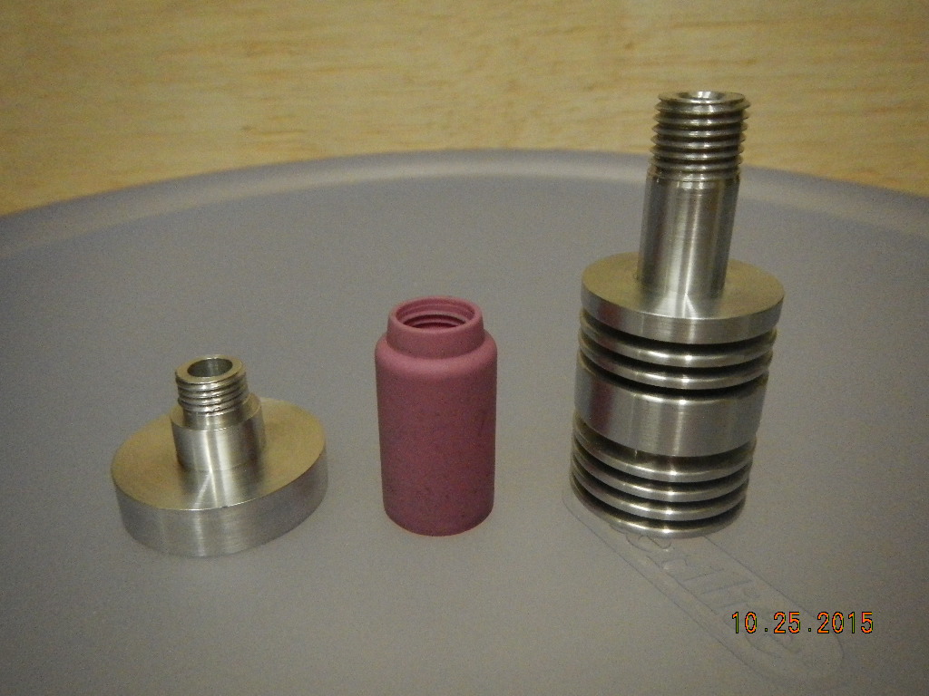

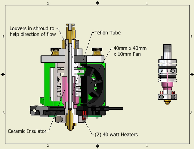

Hi all
Started on a hotend that can go over 300 c, I have got a Smoothieboard, and in process of setting up a head assembly to see
what this will take. I have a 40mm fan, and have built in louvers to help to direct the cooling of ceramic, and aluminum holder,
(upper hotend piece), and a deflector to decrease amount of heat being blown back to the hotend tip.
The overall height will increase by about 5/8". I will post as I build it.

Re: 300 C+ HOTEND
The PTFE tube is only good to about 250C and even at that PTFE will deform, it also puts out very dangerous fumes if it gets too hot.
Using something to structurally support a central PTFE column is something that has been used many times in designs, but I think you'll find you won't get away with just a 4mm tube in there because of the deformation. Many of the early hotend designed tried to use Teflon structurally and they all failed, later they used other materials to support it which is why until the all metal hotends appeared most used a teflon tube inside a PEEK structural element.
The Ceramic hotend thing has been tried, the Chess Hotend springs to mind the original idea there was that the ceramic would be smooth enough to not require the PTFE, that turned out not to be the case at least for their initial batches, so they are sold with a PTFE tube in them.
One concern I would have is the length of the transition zone, and what happens as the ceramic starts to soak heat in from the heater below it, I suspect it would take a long time to stabilize, and it's properties will be changing until it does.
A longish transition zone isn't necessarily bad on it's own, but it can lead to problems with retractions and dribbling, but the JHead which I and a lot of people still consider the best hotend for PLA doesn;t have a particularly short one.
Now having said all of that the only showstopper I see is the PTFE, let us know how it goes.

Re: 300 C+ HOTEND
Thanks Guys
Had a bad feeling about Teflon due to the toxic fumes on over temperature, Has anybody tried high temp graphite, it will take temps to 426 C, I don't
know if it will rub away from the filament. People I guess need this temp for the new flex material.
High Temperature Conductive Graphite maybe 1/4" Diameter or better. I want to print poly carbonate.
What do you think?

Re: 300 C+ HOTEND
I use graphite carbon journal bearings in high load applications. They are always lubricated, but we do perform accelerated wear testing in a dry state and the failure point is normally a hard chrome shaft rather than the bearing itself.
I would expect very good life used as a sleeve. It will rub off a minor amount at first, but should settle down. I don't think a little bit of carbon will hurt the filament much other than possible discoloration.

Re: 300 C+ HOTEND
Great potential. I like the way this group thinks.
One thing to keep in mind most thermistors go up to 300°C. Beyond that you'll be switching to a thermocouple. I not sure what other changes that would entail but I'm sure someone on here is better versed in this area.

Re: 300 C+ HOTEND
If you're already looking at special thermistors, why not consider something like the PT100? even higher potential temperatures, plus a more solid physical package, and wide-spread compatibility. I understand that the latest version of repetier supports them out of the box, E3D offers a reasonably priced adapter board (plus you could make your own if you don't care to go with E3Ds). They are larger though (1/8 inches appears to be the perfect size of hole for them to slot into), and do require you to wire the amp to different pins from the thermocouple jacks. Although I figure a novel thermistor like that would have some teething troubles to match the hassle of a PT100.
