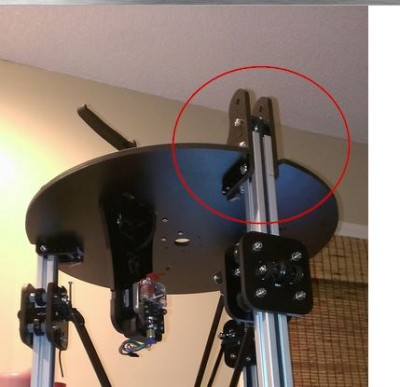

This may be a limitation of the V2 printers. With the V1, you can square the towers before ever installing the top because it is only one melamine sheet thick. Also the top base sheet and the top sheet don't have fitted thru- holes for the towers, but open slots. This means you should never have to pry on any sheet to make a tower square.EL Cuajinais wrote:But how do you fix unsquare towers!? The frame is melamine and easy to break, all towers are coupled at the top so that pulling on one pulls on all the others. I even emailed the SeeMe folks and one of them confirmed all they do is slide the towers down the melamine and that’s it. No digital angle thingy or anything like that. The fact that SeeMe “fixed” a printer from one of the users here by shimming the bed is telling. Why did they not square the towers instead? I think it’s because it’s practically impossible. If you pull too much on the melamine you can break it. And what little progress you may gain when pulling and tightening is lost because the other two towers are coupled to the one you just adjusted (and so the other two towers lose alignment). And if you adjust that towers without the melamine top, they may not fit in the melamine. You may end up moving the towers a bit to get the melamine top on, throwing off your tower squaring work in the process.

Interesting. I did not know of this important difference between V1 and V2.0110-m-p wrote:This may be a limitation of the V2 printers. With the V1, you can square the towers before ever installing the top because it is only one melamine sheet thick. Also the top base sheet and the top sheet don't have fitted thru- holes for the towers, but open slots. This means you should never have to pry on any sheet to make a tower square.EL Cuajinais wrote:But how do you fix unsquare towers!? The frame is melamine and easy to break, all towers are coupled at the top so that pulling on one pulls on all the others. I even emailed the SeeMe folks and one of them confirmed all they do is slide the towers down the melamine and that’s it. No digital angle thingy or anything like that. The fact that SeeMe “fixed” a printer from one of the users here by shimming the bed is telling. Why did they not square the towers instead? I think it’s because it’s practically impossible. If you pull too much on the melamine you can break it. And what little progress you may gain when pulling and tightening is lost because the other two towers are coupled to the one you just adjusted (and so the other two towers lose alignment). And if you adjust that towers without the melamine top, they may not fit in the melamine. You may end up moving the towers a bit to get the melamine top on, throwing off your tower squaring work in the process.
