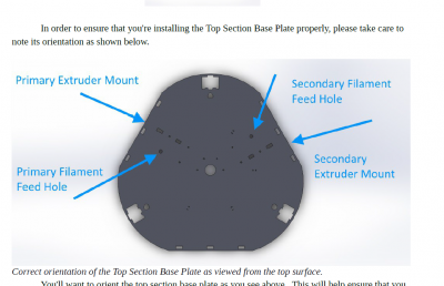

Can someone please tell me what the heck is with these appalling instructions....
Page 94 of the new instuctions have an image of the top plate - making sure you get it the correct way up.
That image wasn't in the instructions I was using, so I went by the pictures throughout the instructions.
Turned out - according to the picture on page 94 that my top plate is the wrong way around. So I dismantled all of it - breaking part of the laser parts doing so, to find that later in the instructions nearly all the pictures show it the way I had it in the first place.
So which way is right? Page 193 shows it totally the other way around from the guide on page 94
Shockingly bad instructions. How hard is it to have pictures that match up throughout the build.
So great... its busted now

How can this attached image from the new instructions be correct?
There are no tie-wrap cable fixing holes running from the bottom left tower (X) to the rear (Z) tower?
Looks like I dismantled everything for no reason.
Re: Steves new build project. Sept 2015
USE TAPE.
The original spin of the 2nd edition had an error in it. The 3rd Ed. (done about *8* months ago) fixed this - mostly. If you follow the text under the image shown above, you'll be fine. No, the wire tie holes don't match.
I didn't re-shoot all the photos because I wasn't willing to tear a working printer down that far. I DID replace some of them - the important ones anyway, while building a printer for someone else.
The image IS correct.
Had you started with a manual that wasn't 8 months out of date, you'd probably have a lot less problems.

The only thing I find appalling or shockingly bad is all the criticism that Gene's manual gets every time someone chooses to follow photos instead of RTFM.Stevolution wrote:Can someone please tell me what the heck is with these appalling instructions....
He doesn't even work for SeeMeCNC and yet people constantly complain about an OVER 200 page build manual that he put together on HIS OWN TIME...

You have to see it from my point as well.   I saved up a LONG time to buy this kit.
People check their progress using the photos. These images being mixed through-out parts of the build simply adds doubt and frustration to assembling it.
I have watched a couple of Youtube videos on the building of these and they appear to have their top plate in a different orientation to the page 94 image. I can only assume the layout has changed.
It is unfortunate that I started with the incorrect version of instructions. I downloaded them a short while ago to have a pre-read through and didn't know they had released newer ones. So I did RTFM
Maybe include a disc in the kit with the PDF file that is relevant to the kit?
So if Gene put this manual together (and I do thank him).... and people constantly complain about it, why don't SeemeCNC put together a correct manual? Its their kit.
Anyway... this was supposed to be a build thread, not a rant. Going to pack it away for now. I won't bother anyone else with my frustrations.

The new drop of the manual will include a photo of one of the v2s at the shop.
I understand your frustration with the photos, but I DO clearly state at the beginning of the manual that the photos don't tell the whole story.

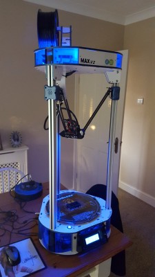

Well the printer is built, and I have been playing around with it.
So far... the results ain't all that great for some reason
I am having better results with ABS than PLA. Printed some fan shrouds that I designed. They were passable.
Basically I am having issues with blobs all over the place (ABS).... lower temp - 210 deg instead of the default 228 deg does seem to help that but then that seems to affect any bridging.
Also scruffy corners and stringing.
I have the E3d v6 hotend installed with the default 0.4mm nozzle. Seems pretty good (for what results I have had). Any advice on what settings people are using would be great.
I can't use Slic3er in the Mattercontrol, as the objects I import are way off the centre and up in the air. Is there any way of returning them to the centre? If you ask it to print using Slic3er... the hotend just dives off the hotbed looking for some way off co-ords.
Cura and Matterslice seem fine

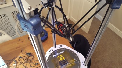

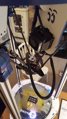

Well 'Chappie' is running well. Have not done much PLA printing... mainly ABS, but getting good results now I finally have it dialed in.
Printed some working dolls house windows last night and they came out very well.
Adding an 80mm fan to the plain panel on the right hand side to help with ventilation. Best option I did on this was the upgraded 750w modular PSU. Its been excellent and much tidier to work with.
Managed to dial out most of the warped hotbed as well - plus a bit of adapting and fixing improvment. Robosavvy and SeeMeCNC have basically ignored any contact I have made with them about this issue.
Same goes for the plastic side panels. The laser has cut clean through the side panels leaving a hole instead of lightly scribing them with the identification marks. I asked SeeMeCNC about that (as the panels are really fragile on the corners now) and they said that they had a bunch of them cut too deep. So basically tough then.
Printed 3x layer fan holders. First I redesigned a model I found online to hold my 24 LED RGB ring and then fitted them. Got one fan installed and at 100% it doesn't seem to affect the nozzle temp at all.
So I have 2x more 30mm fans coming to balance it out. I will just run them slower.
Fitted RGB leds throughout the entire printer. Side 25w 'D' plug gives me access to the PSU and the RGB leds remotely.
I am building a custom enclosure and cabinet that will have a touch screen to control the LEDS, along with a dedicated laptop, filament storage underneath and a glass heated enclosure for the printer.
I also fitted a thermistor on the inside of the RGB ring to report back the temp at that point. I may get that to change the colours of the hotend LED ring depending on temp.
The RGB leds are also remote control. Thats how I have them now. Set to white, they are very handy for seeing your print.
3ED V6 hotend took some configuring, but seems to print well.
Printed a fan cooler for the extruder stepper and added that.
The 5x pin socket on the side (above the USB port) is for programming the onboard Arduino Pro Mini. That controls the RGB Adafruit LED ring. It basically takes the RGB signal from the LED strips used throughout the chassis and converts it to a data signal the RGB ring can accept. Its so that the ring can be the same colour as the chassis if I want it to be.
Few other tweaks.... blue illuminated on/off switch (so glad I painted all the edges blue - looks way better than plain).
Currently also working on a motorised spool holder. Oh and a webcam so I can have it picture-in-picture on the living room TV or on my phone.
