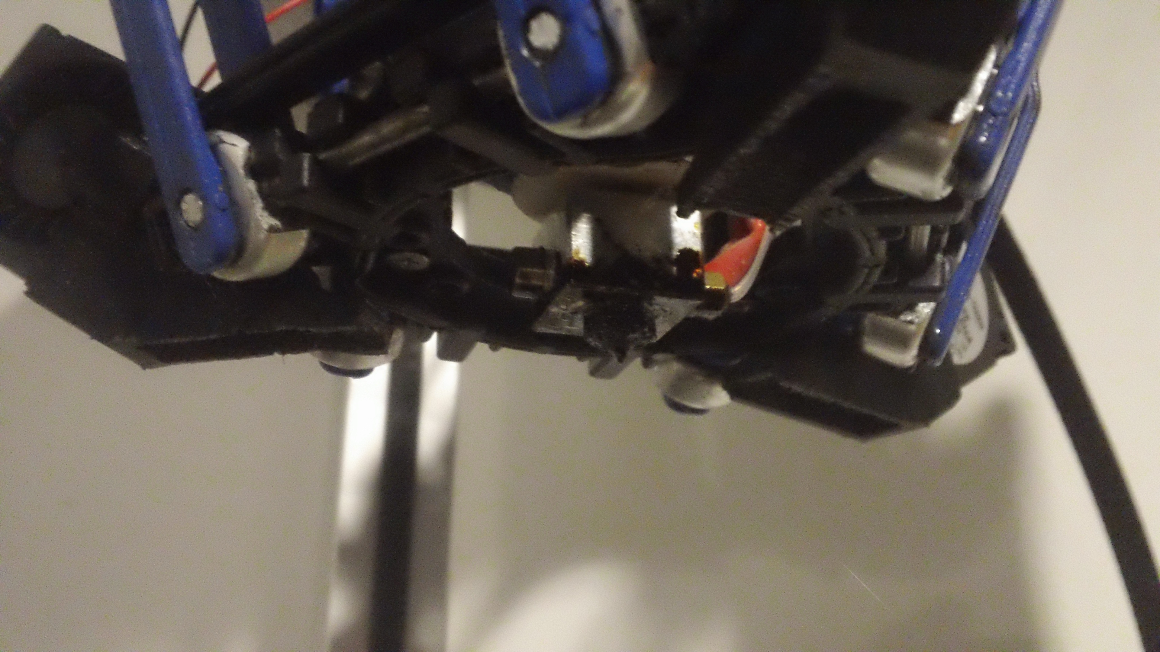

OK the old SeeMeCNC sideways output fan shrouds hang to low with this E3DV6 Lite mounted. What shrouds is everyone using?
Several to chose from here: http://repables.com/r/553/
*not actually a robot
Just installed this new mount on orion with e3dv5 and the new seemecnc base plate with 3 layer fans
modified the old layer fan style shrouds but trying out the ultra low profile from the previous link post.
using a custom length standoff for the mount of 45mm.
just a quick note, the 45mm custom length i used caused the old stock layer fan to hang to low, and the length could stand to be a few mm shorter but doing so would bring the extruder fan shroud up against the
base (tight fit) so i chose to stay with 45mm and mod the layer fan shrouds. will post my results with the super ultra low profile shroud.

Thank you sir.bot wrote:Several to chose from here: http://repables.com/r/553/
printed out super ultra low profile shroud and tested on orion delta with new seemecnc extruder platform and e3dv5 works for me
with 45mm standoff length.

So i got mine in today. Looks great, love the blue. I do have one question. when i seat the v6 in the mount it rocks back and forth a bit like there is a hump along the surface of the flat. Is this part of the design or am i just imagining things?
travelphotog
- Posts: 398
SEBRET wrote:So i got mine in today. Looks great, love the blue. I do have one question. when i seat the v6 in the mount it rocks back and forth a bit like there is a hump along the surface of the flat. Is this part of the design or am i just imagining things?
There should not be any humps as the recess is milled in one mill OP as a circle. It should seat completely flat once the lock ring is in place and the heat sink is pushed into the recess. The tolerance is rather tight. If you think it is still not sitting flat after the lock ring is tightened down, just shoot me a couple of pics to [email protected] and we will see about fixing or replacing it for you right away if there is still an issue after the lock ring is tightened.

Oh its definitely serviceable once the lock rings on. I highlighted the area in red. as it moves from the blue i think it's getting lower. it's subtle but if you hold the heat sink and wiggle it you can feel it dip in and out while riding the "hump" that im fairly sure is at the line where red and blue meet. Like i said, gonna give it a shot anyway and if it seems to cause a major issue, ill let you know. I originally thought maybe you had done it to aid in seating the heat sink.
travelphotog
- Posts: 398
SEBRET wrote:Oh its definitely serviceable once the lock rings on. I highlighted the area in red. as it moves from the blue i think it's getting lower. it's subtle but if you hold the heat sink and wiggle it you can feel it dip in and out while riding the "hump" that im fairly sure is at the line where red and blue meet. Like i said, gonna give it a shot anyway and if it seems to cause a major issue, ill let you know. I originally thought maybe you had done it to aid in seating the heat sink.
Could it be the shoulder of the pass through catching a bit around where red and blue meet? That would seem more likely as the recess cutout is a single mill op and should be level. I check each mount for fit with a heat sink and from time to time a few are tight in that area but the heat sink always seats level so they are allowed to pass QC and anodize. The X Carve style mills are of course that the greatest in the world and not really meant for aluminum milling so from time to time there is an issue here or there. I work hard to try and make sure all the mounts we release are within as tight of a spec as i an get on that style of mill. Saving up for the Tormach..
Matthew
I came back to say the same thing. I filed a very small bevel to the inside shoulder on both sides and it slid right in. It's definitely right this time as there is a significant difference in the height it sits at. After repeated removals it's definitely wearing away at those two Red/Blue lines the fastest so I'm thinking it just had a bit of a nub left over like you said. Would I be correct in assuming that's just some material getting pushed up as it moves down to clear the pass?
Definitely not trying to complain at any point here. I love the mount, and your working wonders with your current tool set. I just wanted to provide what feed back i could. Thank You

SEBRET wrote:I came back to say the same thing. I filed a very small bevel to the inside shoulder on both sides and it slid right in. It's definitely right this time as there is a significant difference in the height it sits at. After repeated removals it's definitely wearing away at those two Red/Blue lines the fastest so I'm thinking it just had a bit of a nub left over like you said. Would I be correct in assuming that's just some material getting pushed up as it moves down to clear the pass?
Glad to hear it was what I was thinking. I will widen that that toolpath on the next mill run and make sure that clearance is no longer an issue. I have a love/hate relationship with the X Carve for sure. But since I am pushing well beyond the limits of what is was even remotely designed for, I try to work with it as best I can.
