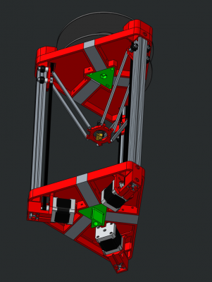

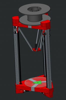

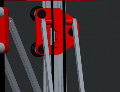

Anyway...here are a couple of rendering of the printer as it is right now. Definitely not complete yet, but I was itching to show off the work so far.
My new belt clamping design for open ended belts...

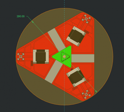

Even with the 25mm extensions to the 3 main frame plates, the entire printer still fits inside a 290mm circle (or a 10.5" x 9.2" rectangle if you prefer).

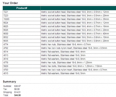

Coming very soon....the design is complete and nearly all the parts are here. Just placed the full hardware order from Bolt Depot. Ordered enough hardware for the two machines plus some extra JIC.

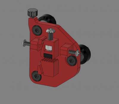

Also, figured I'd share the final carriage design. If you look at the original design in the first post, it has changed drastically. I've played with it assembled to a piece of extrusion with a belt and it is working very well so far.

This is the final carriage and belt clamp design. I'm really happy with how robust and secure the clamp feels.
[img]https://c1.staticflickr.com/1/658/22013 ... 4d43_c.jpg[/img]
