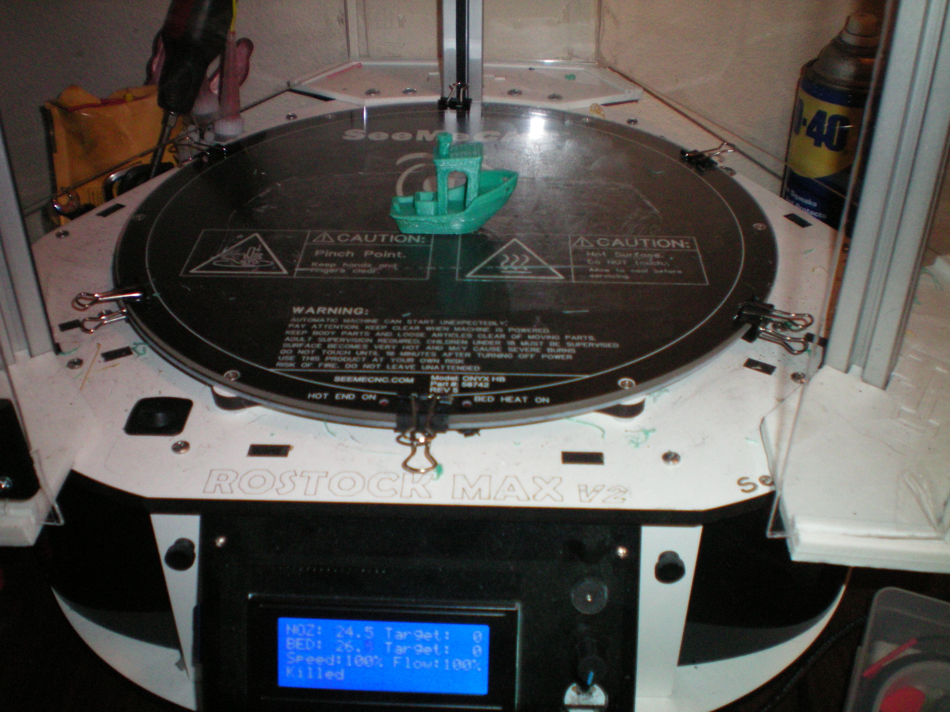

ok so i have been having a problem with my printer. so i will lay it out for you i spent 1 hour leveling the bed last night tried to get everything set perfect and did a simple test print, benchy the 3d printer test set. it ran perfect print cam out beautiful everything was great, then today i ran another program, same slicer setup, nothing different and the printer was left on until i started the curiosity rover this afternoon. then the print head runs right into the bed and runs against the print bed. i have changed nothing between one print and the next so i have no idea why every time i want to print anything i have to relevel the bed. and before you say tighten the belts and the gears on the steppers i checked all that this weekend, along with examing the belts for any problems or wear. so any other ideas would be great

ok so i cleaned and checked all of the arms smoothed everything out and releveled the bed so i was able to run benchy so here is the result. as you can see if the pictures attached right the boat is tipped in the direction of the z tower. i double checked to make sure the towers were free and there was no binding so once again i am stuck on this one. i posted the g code just in case anybody wants to try see if i have a programming error but i have made several of these in different colors as a test so any other ideas??

ok so everything moves freely and easily releveled and still no joy i am beginning to think i may have a stepper gone bad everything works nice but not printing straight does anybody have any other ideas????

well i swapped the z and y stepper motors and now my problems appear to be in the y axis so i am thinking i need a new stepper motor :(

i physically swapped the motors so what was z is now y and now all of my problems are in the y axis. i have to re-level the y axis prior to each print just like before with the z axis so that is what leads me to believe it is the stepper motor. i am hopefully going to pick one up this weekend and replace it. see what happens.

well i finally got my stepper and it appears to be working, i will do a benchy test tomorrow but in the mean time it appears to be level. i was looking for the leveling procedure outlined here
http://forum.seemecnc.com/viewtopic.php?f=77&t=5906
as it is a different method of leveling but i truly think that was a bad stepper because it took minutes to level this time without any problem. so here is hoping things go well
