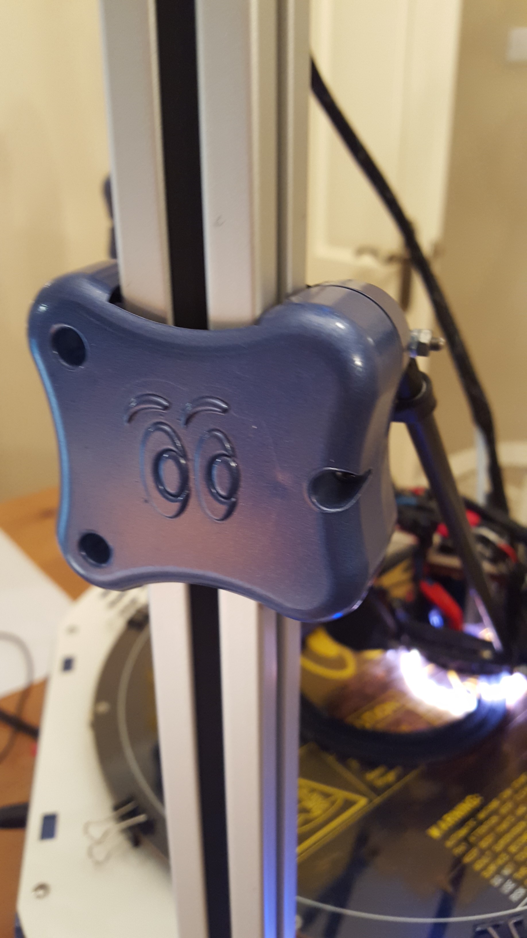

Here is a picture from the back:geneb wrote:I've seen zero instances of them "having issues", so I'd love to see where you saw folks talking about them.
Can you take a pic of one from the back? I'd like to see how you have them installed.
tnx!

Well I am not having issues with the carriages.... but they do creak and groan under rapid movement. It appears to be where the plastic case twists slightly. Pretty sure I have them assembled correctly.
The case screws are as tight as you dare turn them. The issue I read (can't remember where.... during my pre-purchase days)... was someone stripping out the lid screws.
I did change my home stop screws for slightly longer ones than supplied... purely because I found them easier to adjust.

Unfortunately, since they're painted I can't see how the pivot arm is mounted inside the carriage.
Stripping the screw holes is entirely user-error and it's pretty difficult to do.
The carriages shouldn't be experiencing enough force to twist them at all.

They perform well..... just creaky! Certainly easier to put together than the old style by the looks of things.
I am 100% sure they are assembled correctly.
