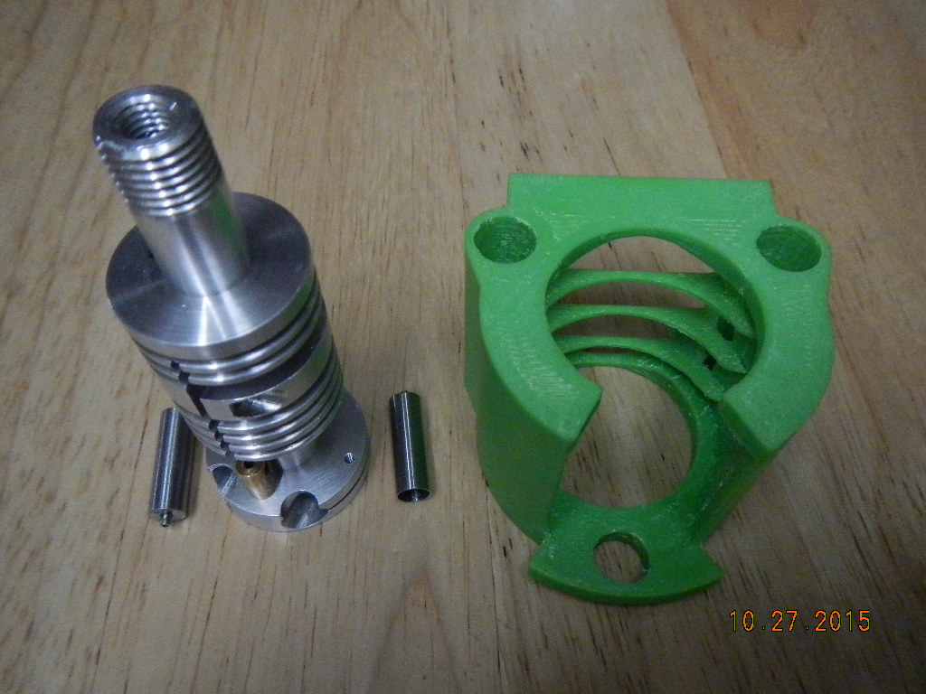

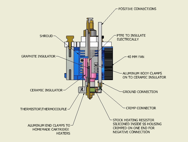

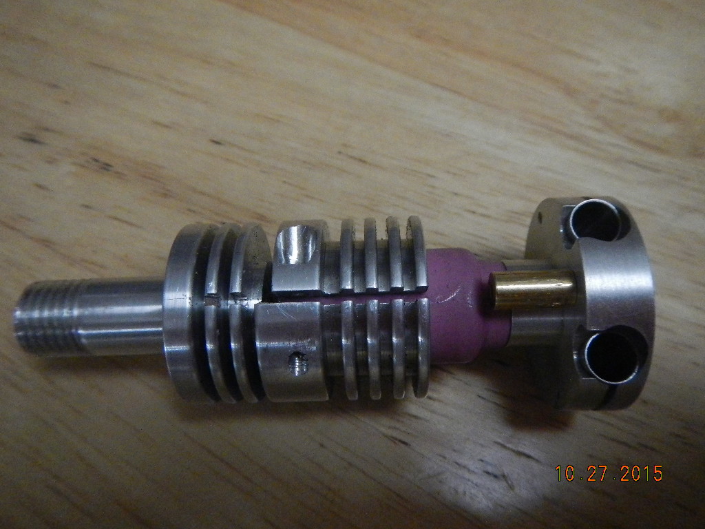

Finally finished the parts for the hotend, now I am setting up a Smoothieboard to test this piece. Jack

Re: 300 C+ HOTEND
Your work shows years of machining and CAD experience, very awesome. I am starting to think about an external power supply brick with a regular power supply rather than a nerfed PC power supply (says ATX right on the box). One thing I am learning over a long time is that 3D printing is not for the office or bedroom environment, even the garage isn't that suitable. That was in the crazy days 3 years ago. A 3D printing station really needs a light industrial environment and when you get into these temperatures, there is some question about the nanoparticles that are being released. Several plastics are known carcinogens and they are the petroleum derived ones. PLA is made from corn starch and the composites are stronger than ABS with above ABS temperature. Good venting is needed and I now see I need an enclosure and venting. Watching the news and seeing more libraries starting to have 3D printers, with the crazy idea they are fine in a side office area. This is not going to end well.
Re: 300 C+ HOTEND
Thanks for the boostkeokolo wrote:Your work shows years of machining and CAD experience, very awesome. I am starting to think about an external power supply brick with a regular power supply rather than a nerfed PC power supply (says ATX right on the box). One thing I am learning over a long time is that 3D printing is not for the office or bedroom environment, even the garage isn't that suitable. That was in the crazy days 3 years ago. A 3D printing station really needs a light industrial environment and when you get into these temperatures, there is some question about the nanoparticles that are being released. Several plastics are known carcinogens and they are the petroleum derived ones. PLA is made from corn starch and the composites are stronger than ABS with above ABS temperature. Good venting is needed and I now see I need an enclosure and venting. Watching the news and seeing more libraries starting to have 3D printers, with the crazy idea they are fine in a side office area. This is not going to end well.
I agree that no machine with a heating element, is nothing to be left alone. I have been working on an enclosure for the max, where smoke & heat detectors could be implemented. I have perfected the extruder to my liking, working on testing the hotend, and have a design for a (2) zone's, with (2) thermistors, an all Aluminum bed that can reach high temp fast, evenly across the bed. I have a 800w stand alone power supply for my testing with the Smoothieboard. Then comes the enclosure.
