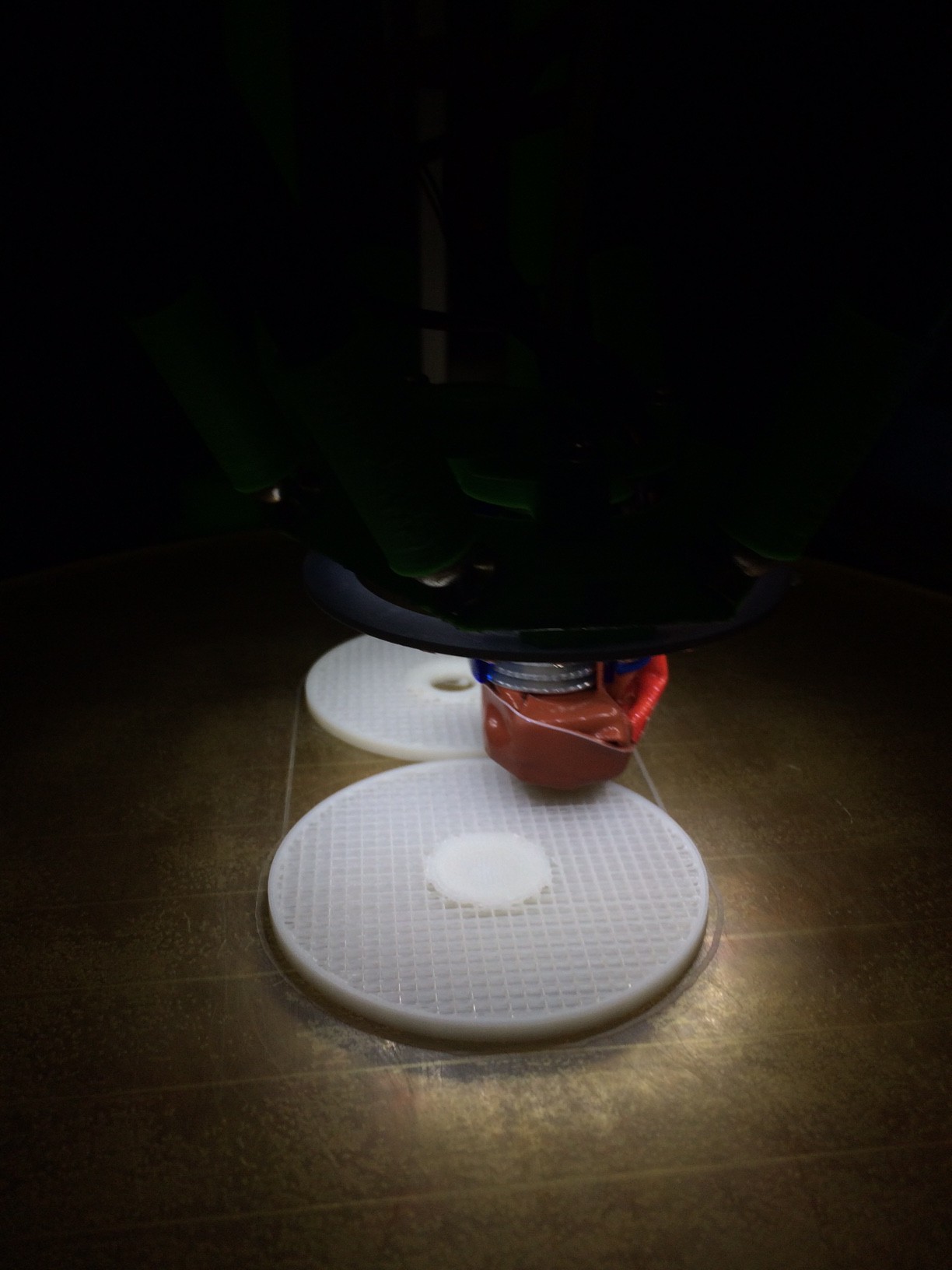

I had the Peek fan cool the hotend while printing, so I now wrap F4 tape on the hotend. You could use kapton tape also.
Hot end with F4 tape
