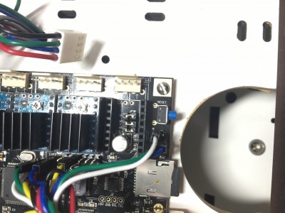

The Questions I have: How to Install the stepper drivers SD 8825?
The ONLY indication is on the "Wiring Diagram"is:
The 3 holes - for "Vref", "Fault" and "Decay" are facing OUTWARDS, AWAY FROM THE CNETER of the board - and are RIGHT NEXT TO Stepper Motor Terminals.
Is this CORRECT?

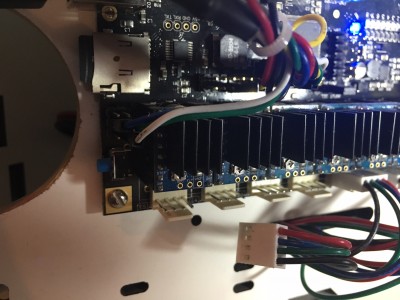

There is NO Switch - but some propel talk about "Jumpers" - but I do NOT see any - are they hidden?
All I see is ONE Potentiometer - but I think that is for the Max Amp Adjustment.

Ok, let's start with the stepper drivers. See this photo, the row of drive slots is at the bottom. I have heat sinks on my drivers but you can see how they are oriented in the slot.
Here's the driver removed so you can see the microscope jumpers. I am using 32 microsteps so all jumpers are installed. I run 32 MS on the extruder too.
