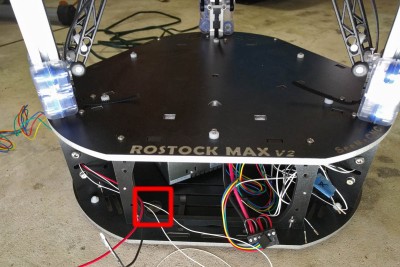

OK, I moved them to G Drive, and "think" I figured out how to post (at least I see them). I finished this baby this morning, and if you can see the last image in the OP, these are my leftover parts. Are any of these necessary? No Smoke! Didn't know you had to be an electrician to build this!
At the end it says plug the USB cable in, but the acrylic won't go on then. I cut a notch for the cable. Also a finished "r3d2" photo (hope these show up!
Question: I am going to put this in a heated enclosure. The Base (bottom 6") won't be heated. I would think the PS fan blowing out would want it's source air from the bottom (not from the heated enclosure). Is it OK to plug the vents on the top surface of the Base?

There's actually a hole in the base plate for the USB cord to be routed through.
I took the liberty of putting a red square around it to show where it is.

Re: r3d2
Psst! Page 142. Fig. 18.2-1. :D :D :D
tcat007
Posts: 68
Joined: Thu Nov 26, 2015 1:19 pm
Re: r3d2
Post by tcat007 »
geneb wrote:Psst! Page 142. Fig. 18.2-1. :D :D :D
Yeah... funny, I read "Route the USB cable up through the hole in the front of the machine..." thinking it meant through the big front opening. I even remember looking at the picture to see where it plugged in. Oh well, looks fine with a little notch in the acrylic.
