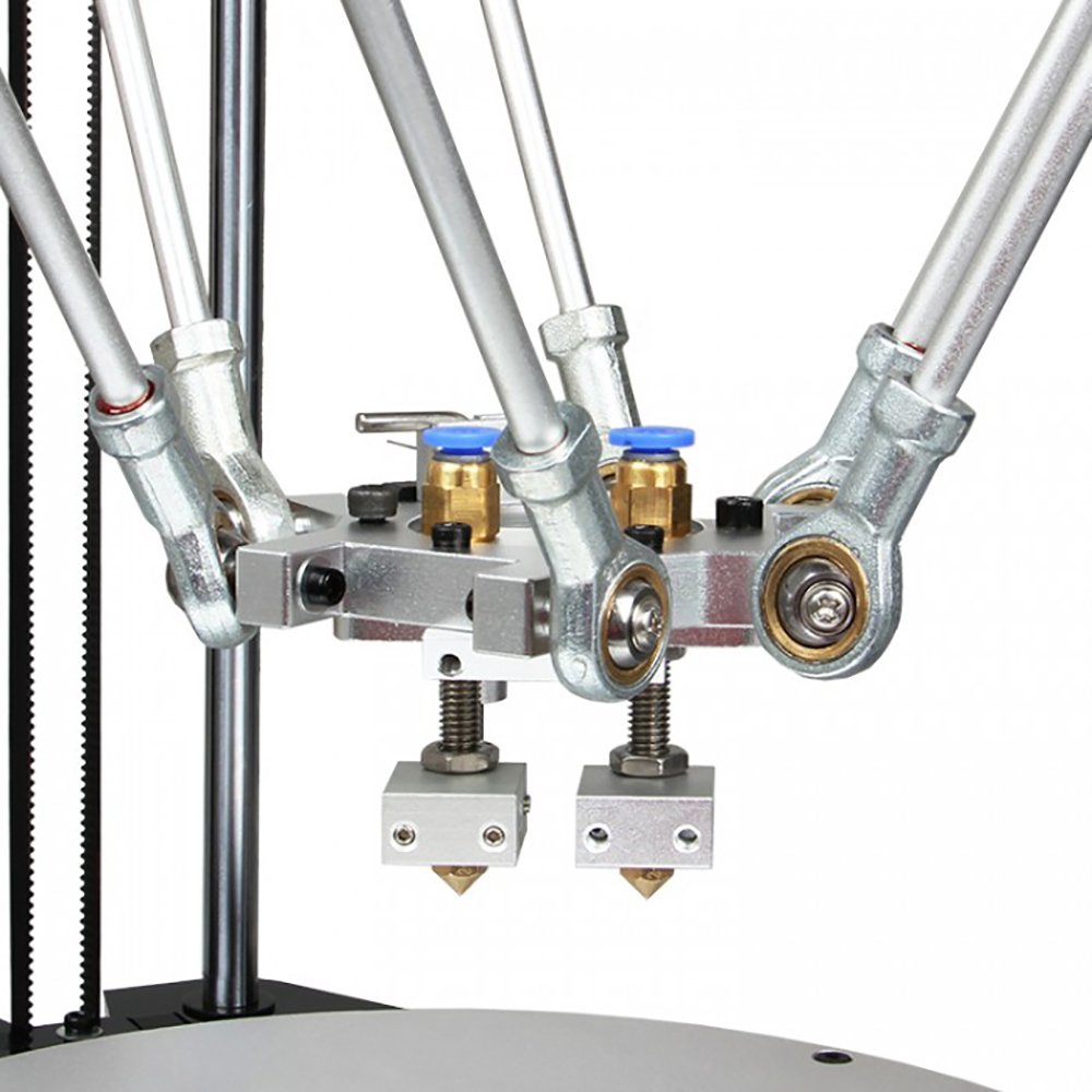

I just came across these from a post on the google delta group: http://ecx.images-amazon.com/images/I/6 ... L1000_.jpg
Not sure who makes them, they are on the Rostock Mini g2 from Geeetech
They *look* tight.

Metal on metal would be my preference for using this kind of rod end.mhackney wrote:I just came across these from a post on the google delta group: http://ecx.images-amazon.com/images/I/6 ... L1000_.jpg

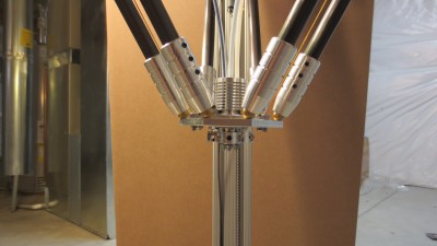

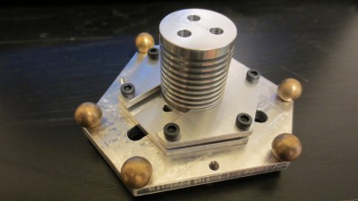

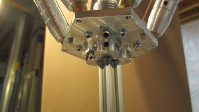

I made some arms a while ago that are relevant to this thread. I put pictures on my Big Delta build thread but I'll repost some stuff here for convenience.
The arm cups are turned aluminum, with set screws locking the CF tubes in place rigidly. They have a .3125 hole that makes a ring contact with a brass ball. The brass balls are threaded, I bought them at a local hardware store but you can also buy them online at some places.
The arms are calibrated with a jig similar to the one in the post above. It's a 24" 1010 T slot extrusion from 80/20, similar to the ones we have on our printers. There are two blocks bolted to it near the ends; one block has a 3/8 ball shaped hole in it; the other block has a tiny detent in it. You put the cups on the arms, then put balls in the cups, then slide the balls into the detent and the ball hole on the jig blocks. Then you lock the set screws so the cups are at a fixed length on the arm. You do this for all 6 arms.
It is repeatable to within about two hundredth's of a milimeter at around 20 inches. Most of the error is from thermal expansion, which is about 0.01 mm per degree Celsius. Wear thick gloves when touching the T slot and do it in a room with stable temperature.
The repeatability between arms is nearly perfect. Unfortunately, you never actually know the distance between the ball centers! Of course you can calibrate it on the printer until it's flat, then assume all other arm sets will be the same. Or if you spend ~120 dollars you can get some giant 24" calipers.
So far the arms work nearly flawlessly for me; they never, ever come off during prints or movement. They have very low friction, and are very precise. If I could, I would get a large batch of ball studs swiss turned and same with the ball cups. The jig method for setting length is excellent, and jigs can be cheaply and easily made (and copied from each other for the same length). I'll get some pictures of the jig as soon as I have access to a camera again.
This setup uses aramid/kevlar threads to hold the arms to the balls on both ends. The aramid thread is pulled through a vented socket heat cap screw, then knotted for tension. I glued them in as well, but the knot probably works better anyway. They are tensioned by springs that are close to the linear carriages. The arm cups are turned aluminum, with set screws locking the CF tubes in place rigidly. They have a .3125 hole that makes a ring contact with a brass ball. The brass balls are threaded, I bought them at a local hardware store but you can also buy them online at some places.
