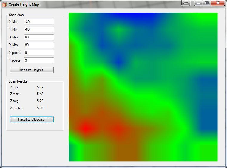

Yes, you are most likely having a similar issue. So if you would like to generate a height map then we could try and diagnose the issue.SirLinhart wrote:Our issue sounds similar to mhackney's. Regardless of calibration method we end up with 2 dips in 2 spots in the bed. Belts are evenly tight, skates are well locked in, rubber bands on the arms. We have an adjustable limit switch Z-probe that we set to match the position of the hotend to about .3mm. Have repositioned the bed multiple times, verified level by using a Starrett level. Multiple iterations though opendact from 2.0 to current on all modes. This has consumed a nauseating number of hours. I did pick up a set of tricklaser arms/effector/skates for a mex metal build, I can try them to see if it makes a difference, that will be our next step. If that fails then I'm not sure what to do besides an entire rebuild, and I'm not sure if Caspers frame can handle it.
If I still see failure, would generating a height map be useful to you Rollie? I could generate it with the Z-probe, just need to figure out how to use the G38 command and then determine a point set to check from.

Can't say with certainty since I don't have my printer connected to the computer at the moment, but either way the gist of it is that you want to emulate the movements the software is doing, and probe more or less in the same place the software is doing, and repeat that a couple of times while nothing down the values to see what's the difference between different readings on the same point, so for example:G28
G1 Z10 X0 Y0 F5000
G30
G1 Z10 X-110 Y-65 F5000
G30
G1 Z10 X0 Y0 F5000
G1 Z10 X110 Y65 F5000
G30
G1 Z10 X0 Y0 F5000
G1 Z10 X110 Y-65 F5000
G30
G1 Z10 X0 Y0 F5000
G1 Z10 X-110 Y65 F5000
G30
G1 Z10 X0 Y0 F5000
G1 Z10 X0 Y130 F5000
G30
G1 Z10 X0 Y0 F5000
G1 Z10 X0 Y-130 F5000
G30
