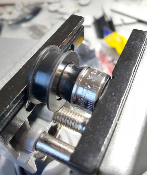

3. Page 56. I would not recommend using the back of a screwdriver to press bearings! Those backs are rounded to fit a hand and will press on the center ring of the bearing. A simple plastic adapter should be supplied for this task (ideally), but a suitable socket will work. A small wise with plastic lips is very handy. Lips are parallel and will press the bearing straight in. 4. Page 89. The sleeves I had in my kit did not have a lip as shown on the picture. So, it was a little confusing.

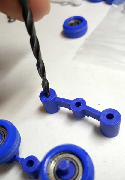

5. Pages 91-93. Assembling the rollers is so much easier if you chamfer the the holes first. A little twirl of a drill bit without any pressure is enough. Using a small wise also made the assembly a breeze. Again, the key here is that wise make assembly parallel.
