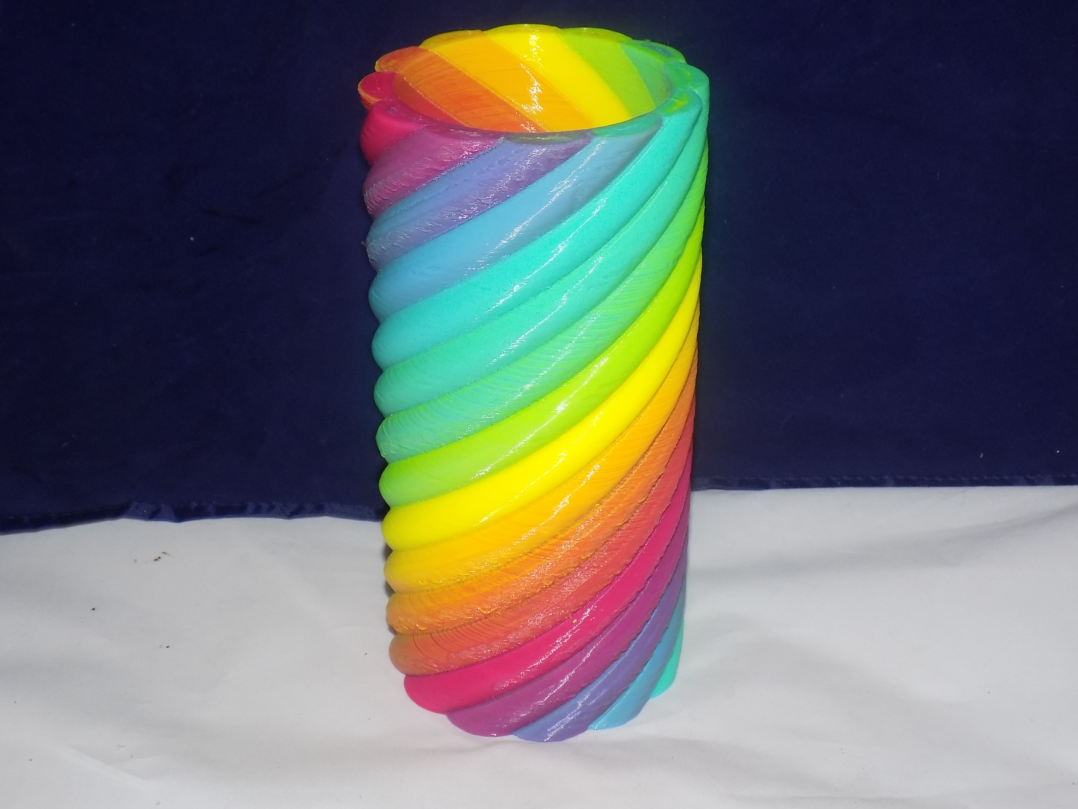

So I finally got it all figured out... Even color mixing... Here's a video of me explaining everything I have done so far...
https://www.youtube.com/watch?v=3Z_21b3 ... e=youtu.be
Here's a few pics of somethings I designed and printed for the diamond

Swell! I need to remember myself to watch the video later today...
What firmware did you use, on what kind of board?

I used the Rambo... And Updated the firmware to Repetier 0.92 to utilize the new color mixing feature.

that's pretty awesome. Not including designing mounts, how long did it take you do get the diamond hotend dialed in like that? I think it would take me a lifetime. I also love the magnet idea, and if you haven't patented it, I would strongly consider it. If you don't, it's only a of time before Makerbot sees your video and files a petent of their own.
