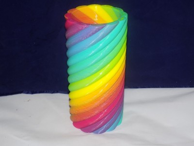

Finally got it all working... Here'a my first two successful prints with the diamond... One is in PLA the other is in Ninjaflex...

So I finally got it all figured out... Even color mixing... Here's a video of me explaining everything I have done so far...

Here's a few pics of somethings I designed and printed for the diamond

Swell! I need to remember myself to watch the video later today...
What firmware did you use, on what kind of board?
Re: Interesting new Diamond hotend 3x filament
I used the Rambo... And Updated the firmware to Repetier 0.92 to utilize the new color mixing feature.
