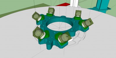

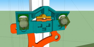

bvandiepenbos wrote:I agree 100% about the tension spring/cord setup looks like the way to go. That's the plan. Either that or two spring each end pulling cup ends onto balls.
However, orienting cups and setting precise arm length as a field retrofit is much harder than screwing balls onto ends of arms.
I do not like the mag-ball-cup arms either, tried them, don't trust them and the stupid things can easily jump apart if you try to move platform by hand.
This is very good news!
I designed my carriages/effector with the ball mounts as separate pieces, so I could redo them to have recessed cups if I went to tensioned ball arms. A 45-degree angle seems to provide optimal range of motion. I also made integrated belt clamps and decided to use the structure itself as an "endstop screw" since the offsets can be modified in firmware. There are two front pockets for captive locknuts, and a curved channel for tying up a flying extruder platform, or for doing tensioned ball arms.

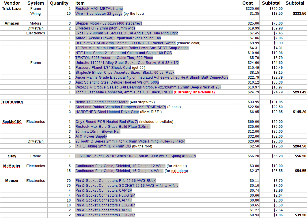

How bout a BOM for those of us thinking about building out a Max Metal Frame?
626Pilot
Posts: 1716
Post by 626Pilot »
This is the basic part of my BOM. It gets you everything except the carriages, arms, effector, hot end, controller, and LCD panel. Doesn't include 3D-printed parts. Subtotal is $1,126.64, shipping excluded.
davec3275
Posts: 63
Joined: Mon Sep 28, 2015 7:24 am
Location: PA
Post by davec3275 »
626Pilot wrote:This is the basic part of my BOM. It gets you everything except the carriages, arms, effector, hot end, controller, and LCD panel. Doesn't include 3D-printed parts. Subtotal is $1,126.64, shipping excluded.
What can I eliminate out of this if I were to use components from my Max V2? This looks like an amazing upgrade and would be worth the time and effort expended.
626Pilot
Posts: 1716
Post by 626Pilot »
You can reuse the steppers, pulleys (if they're the new 20-tooth ones from SeeMeCNC), hobbed drive gear, EZ-Struder, T-slot nuts, power supply, power switch, GT2 belts, binder clips, Onyx + glass, PTFE tubing, endstop switches, controller, and LCD panel. You can also leave out the paracord unless you're doing a flying extruder platform. The John Guest connector is the standard E3D PTC fitting, although they drill it out so you can pass the PTFE all the way through.
You also need a bunch of 3D-printed parts. The git repo is here.

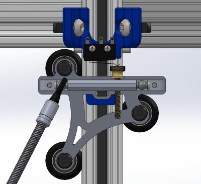

ccavanaugh
Posts: 297
Location: Indiana
Post by ccavanaugh »
I've updated the limit switch bracket with a new version that uses less material and frees up some space on the top rail.
The switch sits a bit lower to clear the assembly screws, but it still allows enough room for end stop adjustments.
It's available in the Git repo in my signature.
Version 2 of the limit switch bracket.
