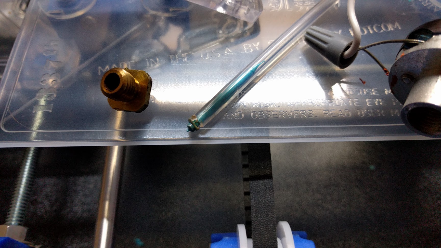

So, I don't know if this contributes to the problem or not... but I took apart everything a few minutes ago to see what I could do to fix these problems, and I noticed the filament tube is melting at the hot end. That probably restricts flow some I'd imagine. What should I do about that?
Posts: 5359
Re: Hot end / extruder troubles
Replace the tube. The stock hot end for the Rostock MAX has the same issue - if you over heat it, the liner will shrink a little bit and play merry hell with the filament feed.

Is there a particular tube that I should replace it with that has a higher melting point?
I rebuilt the extruder last night, another problem I found is that the little clear piece at the top and the black piece in the middle were slightly to wide. If I tightened the middle bolt down there was still a very slight amount of wiggle in the gears. So they were not getting the full lateral engagement that they were supposed to. I shaved a little bit off the edges of those two pieces and got it to where I could fully tighten down the middle bolt and have significant lateral pressure. After doing that and reassembling it the fillament feed is much better.
I haven't had a chance to test it in actual printing again yet because while working with the hotend I pulled the thermistor out (Not sure what I should use to actually adhere to this hot end and hold the thermistor securely, I've tried using high temp copper silicon and muffler silicon, neither work well). It was late by that point and I had to let the silicon cure before reassembling and attempting another print.
Posts: 5359
There isn't a higher temp material. You'll need to replace it with the same size & length of PTFE tubing.
Use Kapton tape to help prevent the thermistor from pulling out.
