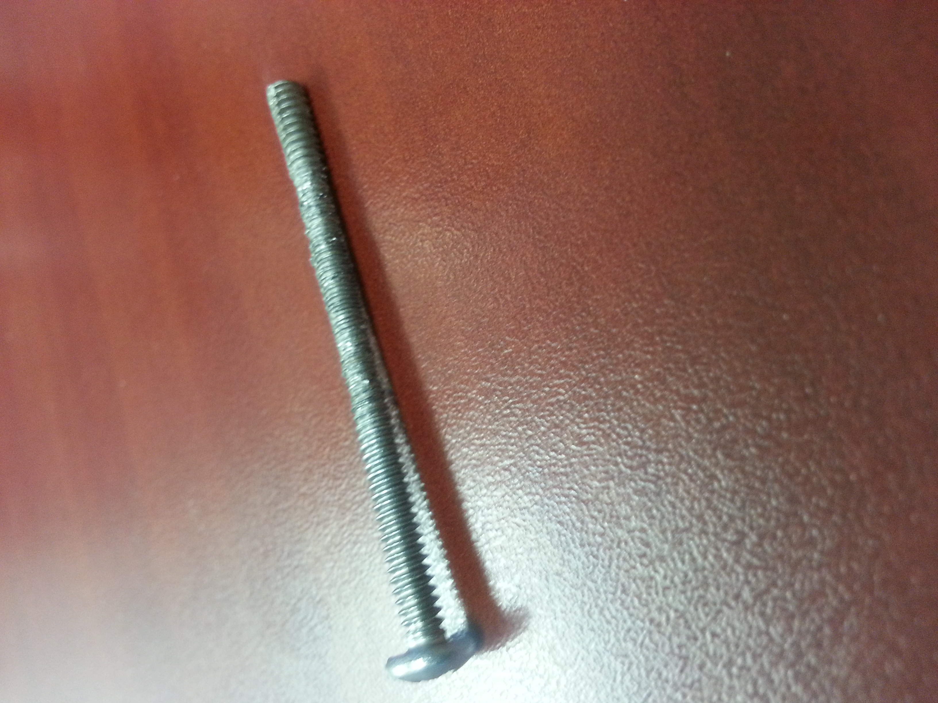

2) Step 16 says (8) pan head screws are required. Step 16.2 says (4) of the same pan head screws are required. Only 8 screws are actually required for both steps. For a few minutes I was worried that I was missing screws...instead I determined I just had a screw loose
3) I have no idea why but when I installed the fan in the step 6.6 every nut bound up and I actually ended up bending all four screws trying to get them tightened properly. I ended up hot gluing the fan in...works fine. Not sure if I used the wrong screws, nuts or what...all other screws/nuts worked just fine. :

I just got the base together on mine. For #3 the same thing happened to me (I had 1 work fine then killed 3). I then used a spare so I have 2 screws holding it in. I think the nuts are just stronger than the long screws, I don't think I cross threaded 3/4 but could be wrong. If I did it again I'd throw some shorter screws through the nuts first and then the long ones so the resistance would be less (or just use standard nuts)
For #4 I think you are okay, I assume they are there to help prevent over tightening / collapsing the holes, just don't tighten them down too much.

For #3 I believe it is the screws. I had exactly the same problem except 2 went in no problem and 2 bound up. One twisted off.
Attached is a photo of one that was left over. You can see the threads are OK at the starting end but then get smushed up
