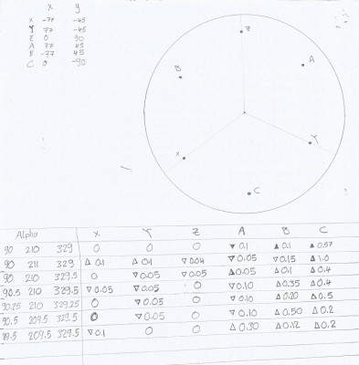

Hello,
I followed this tutorial for rotation calibration, and chocked when found that my alpha angles are 90.5, 207, 333 instead of 90,210,330. I tried to try modifying these angles in EEPROM but found no logic in results. So please let me know how to fix/calibrate that with a logical sequence.
Regards
Aehandasa
Posts: 8
Joined: Tue Sep 23, 2014 10:51 am
Re: Tower Rotation Calibration, not 90,210,330
Post by Aehandasa »
I made some try&error test manually yesterday with changing the angles randomly. Legend is
v x.xx : this point is under zero by x.xx mm
^ x.xx: this point is above zero by x.xx mm
Still I don't know the effect of changing one or more angle, but found the level of more than one point changes related to one angle change.
Ant explanation or guidance ?

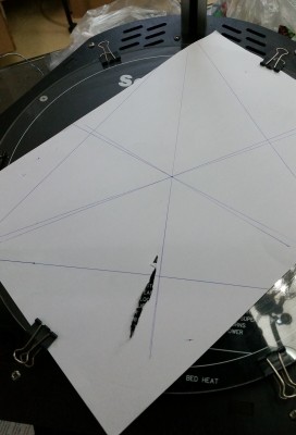

https://github.com/ccavanaugh/Max-Metal ... alibration
Link is for a calibration object and guilde. This is the process I use to bring the printer into alignment without adjusting firmware.

Thanks RegB, ccavanaugh. I believe the most important fix to made is with hardware. I loosen the screws of towers then tried to align the towers again, got better results than before. Now I'll try to fix them more to get more better results. Regards
