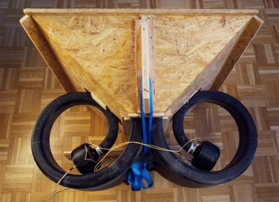

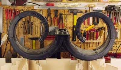

Dual Snailhorn, one part of a much bigger horn.
This part is created with 12 printed segements. Sandwich hull filled with sand to absorb resonance and vibrations.
This part weights completely 25kg. PLA only 10kg, printtime ca.600h. Stay tuned

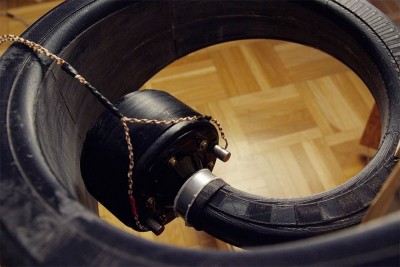

Its a Atlas sound driver, the one the police used to install on their cars.
But its haviely modified, to get a linear frequency range from 80hz to 6khz.
Simulation for the Horn were done with AJHorn http://www.aj-systems.de/indexe.htm
Construction were done with Rhino

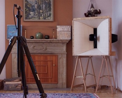

The very first measurments are quite promising, a nearly flat frequency response from 200hz to 5khz thats over 4 octaves, and that is a teriffic result and that with a angle of 70°deg horiz. to 40° deg vertic. The horn it self is developed to support a frequency range from 200hz to 10khz, unfortunately there is no driver that can support such a range
In the pictures below you can see the snailhorn put together with the test flare, this flare will also been printed after the final measurments.

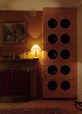

It will be combined in centre with a biradial horntweeter and a large bass array behind,which is a equal method for the bass range.

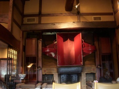

The picture below shows a very special horn, that was one inspiring horn model. It`s a Western Electric 16A. The "mother of all horns", it is the very early version of a cinema horn in the early twenties in USA. Legendary ! Passioned horn lovers are paying x thousands of bugs to get one original.
