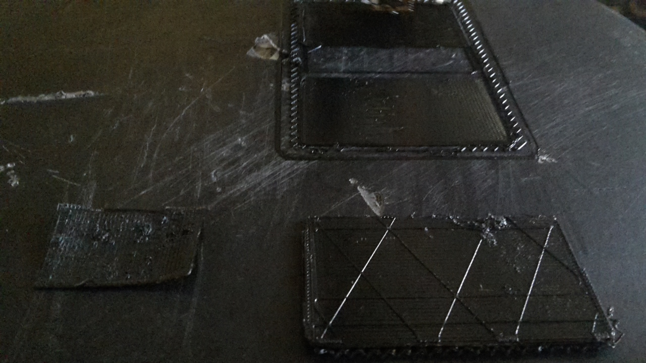

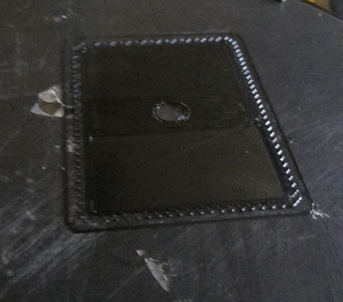

I am going to double-double check my extruder e-steps (Currently at 81.25) because that is all I can think of at the moment. Then I am going to print something in both PLA and ABS so I can illustrate the differences, perhaps that will shed light on this.
Update*****
Here are the photos (excuse the condition of my build plate trying to get as much use as I can out of each Buildtak):
My PLA prints aren't perfect but I am happy with them.
Here are three generations of ABS prints, slowly making progress, but I am still getting small globs and rough ridges, and having adhesion problems as well toward the center. Dropping Z height to see if that has any effect..

I'd run retraction no faster than 45mm/s.
As I said try it with no retraction at all, when your trying to debug problems the easiest way to do it, is to simplify everything as much as possible, slow down to 20mm/s, turn off retraction and see what you get, if that's OK, you can start playing with retraction, and then increase speeds.
