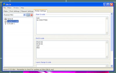

I had to add "M84" at the end of the "Custom G-Code"settings in Slic3r. Otherwise, when it finished a print job, the stepper motors would "hum in unison" (ugh!).
Flateric
Posts: 811
Location: Calgary, Alberta
Re: Slic3r 0.9.9
Post by Flateric »
Is that what that is, thankyou for posting the fix, gonna go try that out right now.
