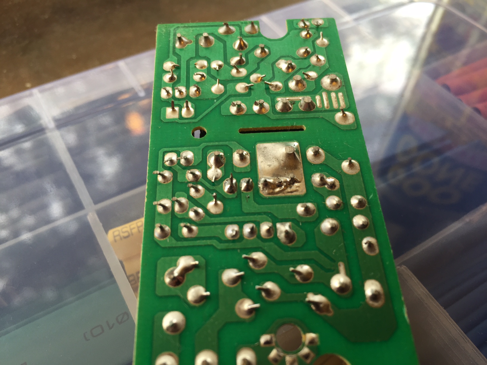

Post by TheIrishScion »

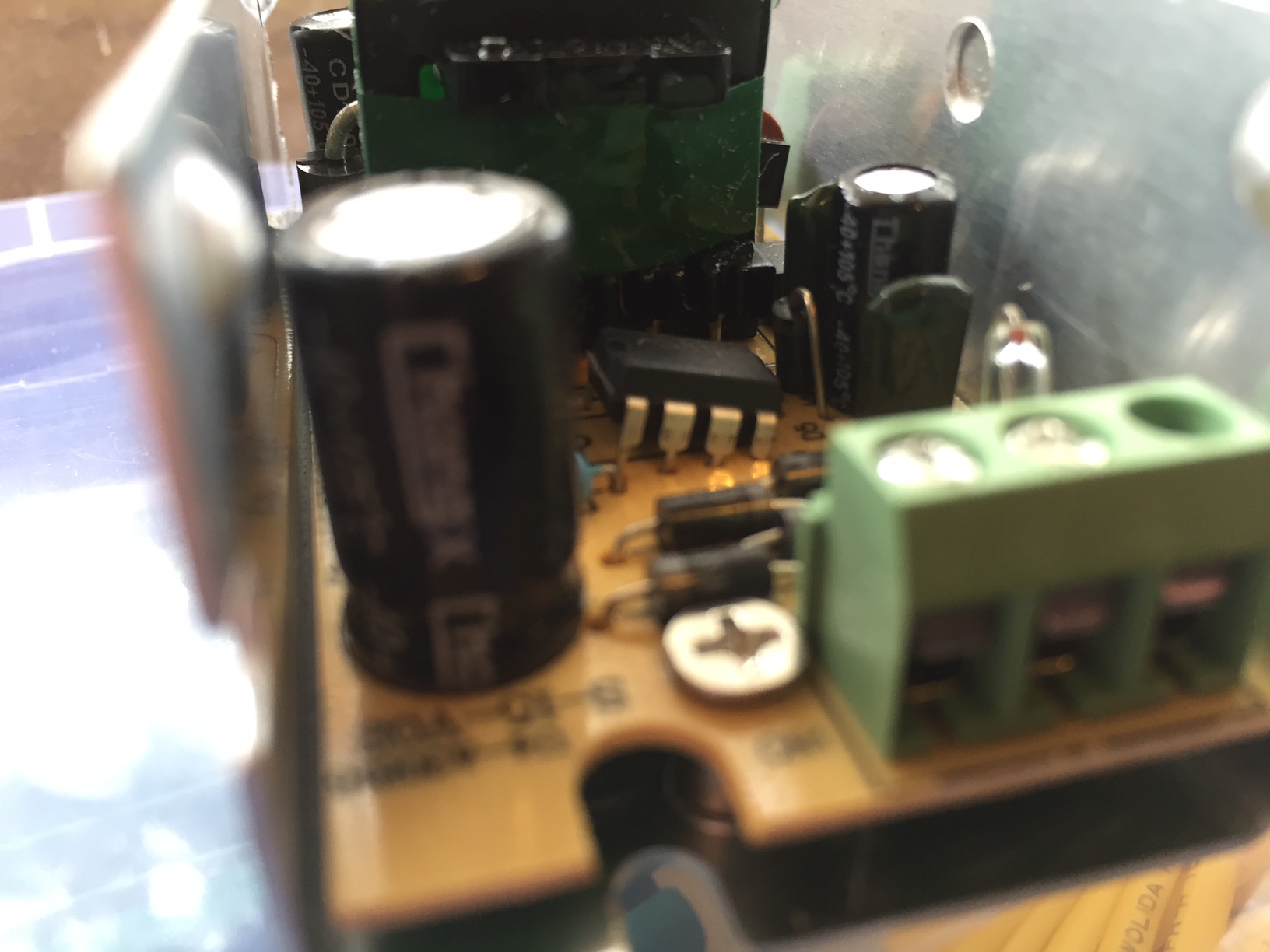

First problem (with solution);
The wages of buying cheap-o (~$10) off-brand power supplies from Amazon is apparently very marginal quality control (which is I suppose better than death, so I've got that going for me);
They did _just_ enough quality control to catch that the board was dead, and reworked the board _just_ enough to get it working. Note the bottom of the big solder rectangle in the 2nd image, that's immediately under the high end of the tilted IC. It's been kissed _just_ enough to get it making contact. They didn't bother actually reflowing the IC properly flat. So while it did supply 5.2xx volts when plugged in, I was deeply suspicious. Suspicions confirmed when I tried to trim it down a little to hit 5v even. Nope. Second the output dropped under 5.2v it lost its tiny little mind, voltage jumping around all over the place. Regulated my arse.
Usual solution; throw money at the problem till it goes away. $37 to digikey later and we have a 5v version of what I should have bought in the first place winging its way.
http://www.cui.com/product/resource/vsk-s10-t.pdf

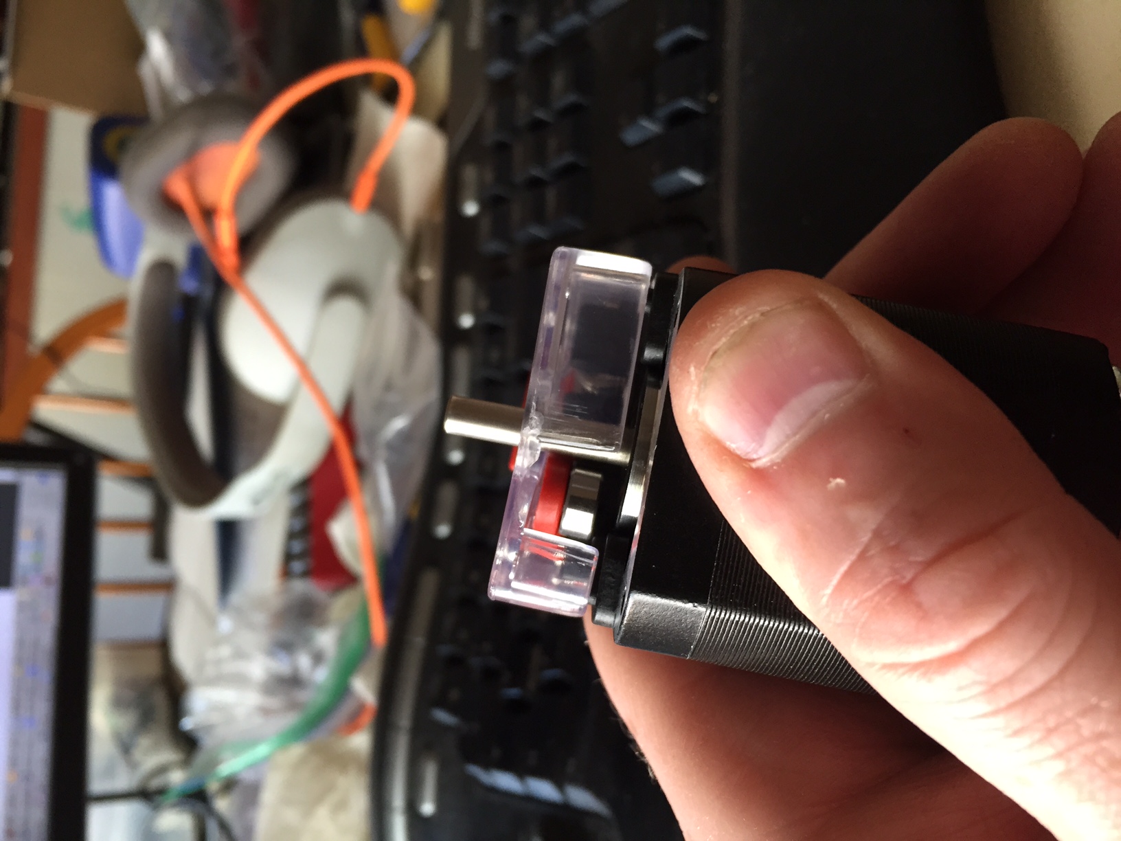

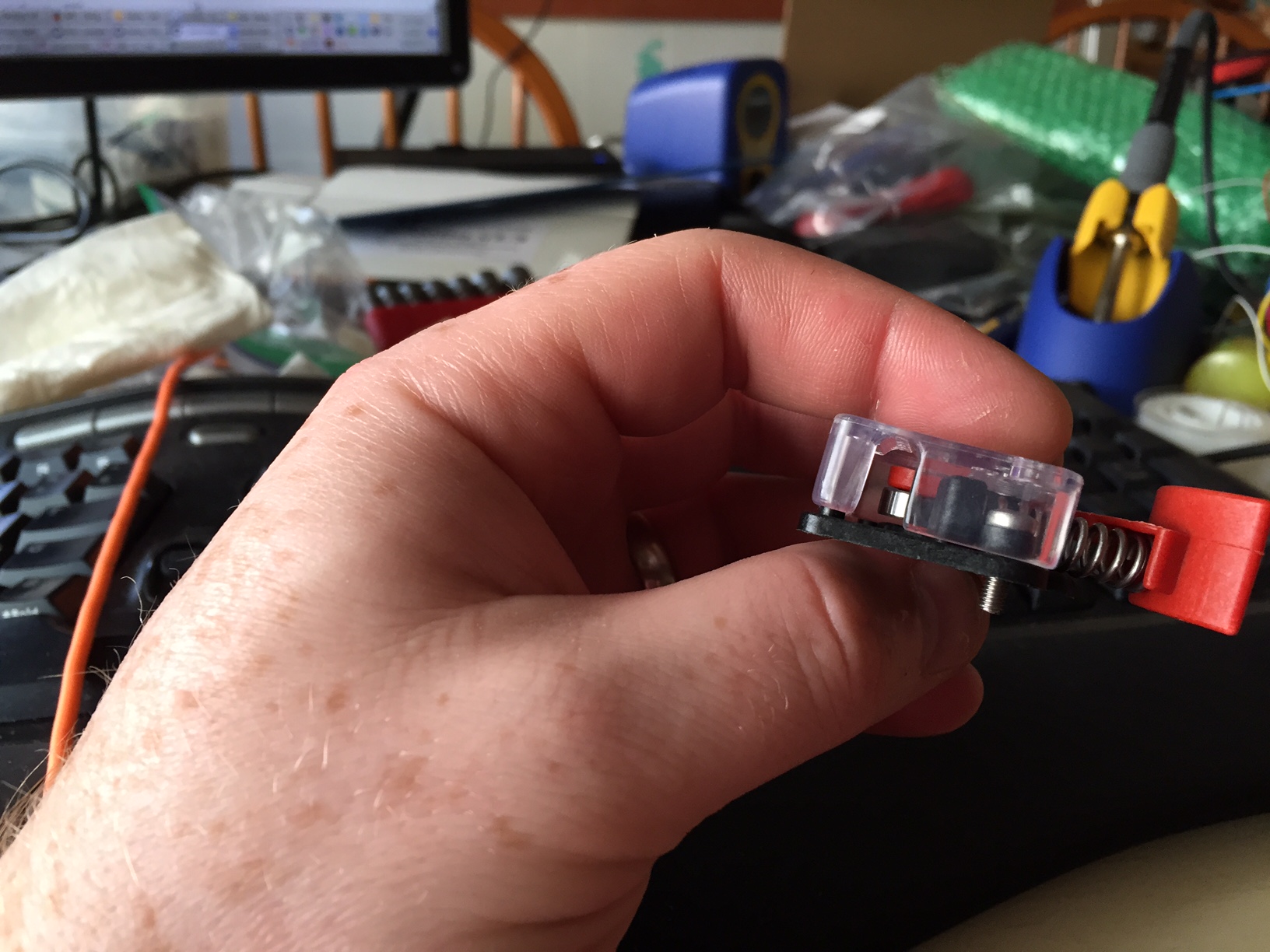

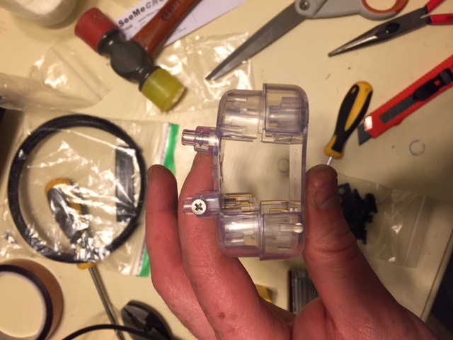

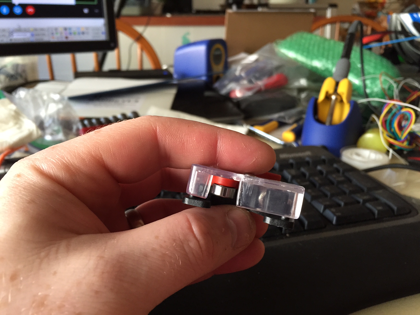

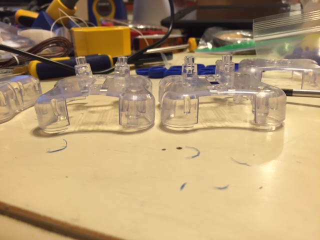

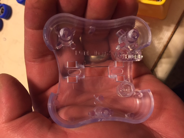

Hmm. I must have done something to peeve the injection molding gods.
My EZ-struder looks to have been either mis-molded or misassembled;
It came in the baggie with the clear cover screw tightened down but the cover itself rotated slightly so it was clamped on top of the locating pegs.
I loosened it off and located it correctly but the clear cover seems to have taken a set with the bend in the middle
This wouldn't bother me except that the clear cover looks like it's designed to control lateral movement of the sprung idler bearing arm, which I've read is liable to slide off the filament if not fairly accurately aligned with the hobbed portion of the capstan. If I hold the parts flush together the idler has very little play, but if I don't it can move around more than I like relative to the capstan. And I'm concerned that when the whole assembly is hot, any play I'm seeing cold is likely to be magnified. And I don't want to loctite everything together until I'm fairly confident I've got the capstan aligned correctly.
So, back to support we go :-)

jjjohnson
SeeMeCNC Staff
Posts: 36
Joined: Sat Jun 02, 2012 9:31 am
Location: Goshen, Indiana
Re: Dermot's RMv2 Build
Post by jjjohnson »
Sorry about that. I have a new part shipping today.
JJ
