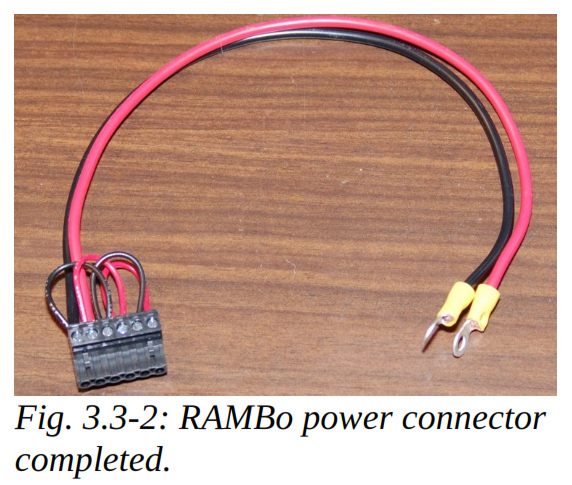

I suspect you've got stepper motor wires running in parallel with the bed power wires - that would explain the issue that you see and nobody else does.
I'd also try measuring the voltage of the bed during it's constant-on heating phase to see what the voltage output is - make sure your hot end is heating as well.

Running the wires in parallel is how the assembly guide instructs it to be done so I would assume everyone else has them wired in parallel as well if they followed the instructions.geneb wrote:I suspect you've got stepper motor wires running in parallel with the bed power wires - that would explain the issue that you see and nobody else does.

That's not exactly what he meant. I believe that he referred to the 4 wire sets which go to the stepper motors from the Rambo being too close to the wires which go to the bed from the rambo, rather than the wires which provide power from the PSU to the rambo (which will always be in parallel as the PSU doesn't have multiple rails)

I'm not sure how close proximity those wires are, but to me proximity of wires means something completely different than running in parallel. I ran the wires according to the assembly guide and tried to keep them as neat as possible considering the tight space you have to work in.Xenocrates wrote:That's not exactly what he meant. I believe that he referred to the 4 wire sets which go to the stepper motors from the Rambo being too close to the wires which go to the bed from the rambo, rather than the wires which provide power from the PSU to the rambo (which will always be in parallel as the PSU doesn't have multiple rails)
For me, the addition of a second PSU solved 2 problems at once: one, the z-ribbing while the heat bed is one, and two, the fact that the stock PSU really struggles to get the bet up anywhere near 110c for running ABS. It heats up much faster now and stays there stably.
