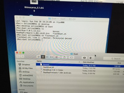

I am trying to update the RepRapFirmware. Downloaded all the files mhackney posted (bossac application, firmware.bin, and the flash duet.sh), updated my port information.
Attached is the error received.
What am I doing wrong?
Thanks.
Thanks.
Re: Duet setup - instructions in progress
3D-Print - don't do it that way. The shell script has a problem so run bossac from the command line as per my original blog post here: http://sublimelayers.blogspot.com/2015/ ... -os-x.html
Sorry for the confusion. I need to sort out the problem in the script. Here is the actual command you run in a Terminal window (assuming bossac and the firmware .bin file are in the same folder and you 'cd' to that location:
/Applications/Arduino.app/Contents/Resources/Java/hardware/tools/bossac --port=tty.YOUR_PORT_# -U true -e -w -v -b RepRapFirmware-1.09o-dc42.bin -R
Replace the parts in bold with your specific port and firmware.
I'm not sure what arguments and/or permissions that shell script might need. The instructions I've been using to flash mine came from the RepRapPro site, where they call bossac directly, the Mac command being:
The arguments are -e[rase], -w[rite], -v[erify], -b[oot] and the path to the firmware image you want to flash.
Code: Select all
/Applications/Arduino.app/Contents/Resources/Java/hardware/tools/bossac -e -w -v -b RepRapFirmware-XXX-DD-MM-YYYY.bin
Thank you!!
Used your command as detailed. Now I don't have the correct port.
What do you mean by "do an 'ls' in /dev to find see the ports before the Duet is connected."

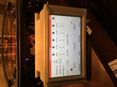

Thanks to everyone and their help........ Was able to commission the Duet and the PanelDue.
After updating the firmware for the Duet, I in similar fashion updated the PanelDue as follows.......... I used the following from the Terminal Screen:
Finally connected the Duet and PanelDue to the new build of mine. Following the instruction in this thread made it quite simple. Thank you Mhackney for such a great write up. Few questions linger. When I Home the axis either through PanelDue home button or through G28 command it moves VERY slowly. Is there a way to adjust the homing speed to have it home faster?
Also in the sample config.g file Mhackney has
Is X -0.22° Y -0.16° Z 0.00 specific corrections to your printer?M665 R182.55 L288.0 B105 H255.83 X -0.22° Y -0.16° Z 0.00
