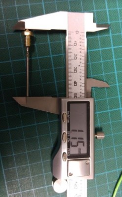

mhackney wrote:...leaving a tiny gap between the nozzle and heat block.
Yeah, I remember your investigation concerning the long orifice of the nozzle, combined with the tiny gap you just mentioned.
As it happens to be I received some 0.4 nozzles in the mail few days ago, and measured orifice lengths of 1.2 to 1.4mm.
So it seems that the design is not yet adapted (or I received older stock).
Should I bore them shorter? Do I need to polish the inside afterwards, and how would I do that?
Re: Upgrading the HotEnd: Prometheus vs. E3D vs. ???
I would proceed carefully and not modify them at all. I've ordered well over 30 of the .4mm nozzles in the last year in 6 different batches and they have all been spot on. Did you get yours direct from E3D or from a reseller? If a reseller, I would raise the flag with them. If from E3D you might email them and ask what's up.
Otherwise, make sure you did indeed measure accurately. If so, then test the nozzle by printing before boring.
I did not polish mine when I bored but I did burnish by twisting the drill backwards (using finger tips only to power the drill - no motors!)

mhackney wrote:I would proceed carefully and not modify them at all. I've ordered well over 30 of the .4mm nozzles in the last year in 6 different batches and they have all been spot on. Did you get yours direct from E3D or from a reseller? If a reseller, I would raise the flag with them. If from E3D you might email them and ask what's up.
Hmm, I took an other one from stock, and measured 1.14. If I remember correctly you advised an orificelength of about 0.6mm right? I got these directly from E3D. I zeroed my caliper at the length of the drillbit, and then measured agin with the drillbit inserted. I don't know how much the inner angle of the orifice measures, of course if that differs from the drillbit that would throw my measurement off... Would you consider this a faulty nozzle?
Take a look at the drawing: http://wiki.e3d-online.com/images/b/b2/ ... NOZZLE.png
It looks like they step down the orifice and the .4mm diameter section should be .80mm in length. With the step down to alleviate pressure, this geometry works fine. I'd leave them alone and try them out. I haven't had any issues with mine. This new geometry is more difficult to measure unless you an get a 1.5mm drill and be sure it is seated all the way into that little recess.
