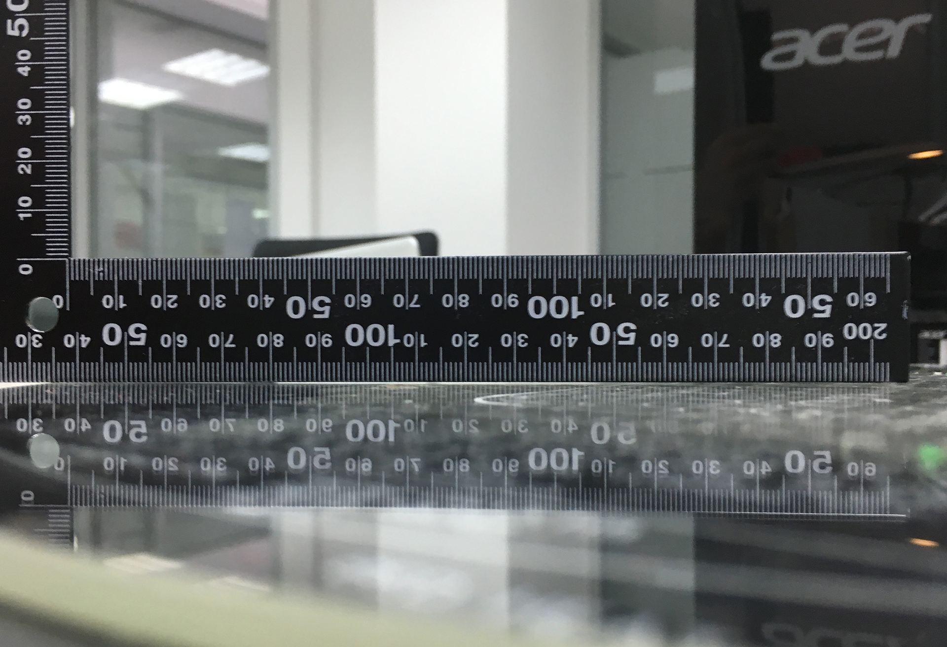

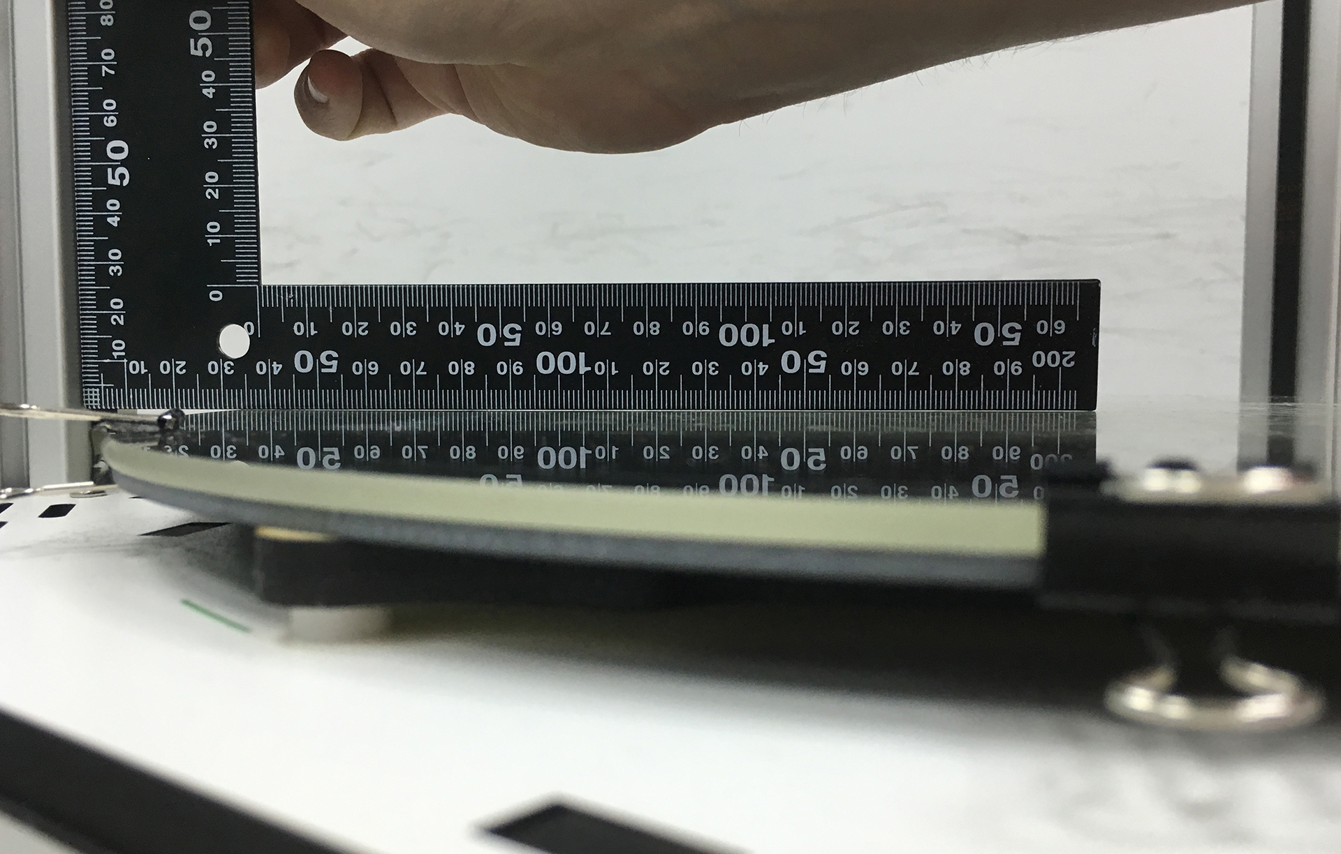

Below are pictures of what it looks like with a square. I guess that would be the problem, right? Is there an "easy" way to adjust the towers? Do I have to suck it up and take off the top part and do it like is in the instructions?
X Tower:
Y Tower:
Z Tower:
barry99705
Posts: 707
Location: west ohio
Re: ROSTOCK Max V2 Big Arc on Y Tower
Post by barry99705 »
You should be able to loosen all the screws that hold the tower and tweak it a bit. It doesn't need that much of a movement.

Before messing with the towers, remove the glass and loosen the screws mounting the onyx to the snowflake/base.
Heat your bed to 70c then torque down each screw so that the onyx bed is the same height at all mounting points. Use the depth gauge of a caliper/micrometer to determine the height. Don't crank they screws down to much as it can warp between mounting points.
Also verify your square is actually square. It looks a bit wavy although that might just be the images.
