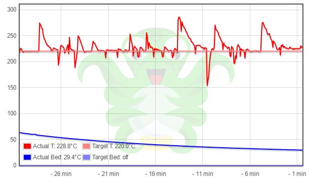

OK, on to my next problem, When I heat my hotend it heats up nicely and quickly and then sits at the temperature i set very stable....until i extrude. as soon as i extrude or retract the temperature jumps. sometimes as much as 30° to 65° off of what I have set. this does not seem normal. i was thinking interference so i moved the thermocouple wires and the extruder wires as far from each other as i could get, at no point are they closer than about three inches. I am trying to figure out if there is a pattern.
I just tried three retracts in a row, it droped about 10° the first two times and then the third time it jumped 65°. 4th retract it dropped 70°. 5th retract went up 50°. this makes no sense. The only trend i truly notice is that when it drops it recovers very quickly but when it goes up it takes a while to get back down. which would make sense since its easier to add heat than remove it.
Ok, i attached a screen shot of the last half hour of my temperature graph...any one have any ideas?

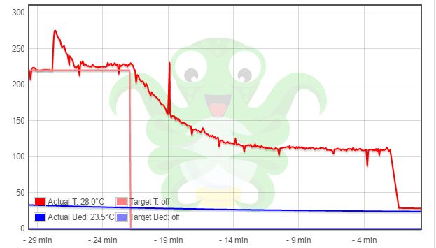

So this is interesting. the tempearture seems to have stabilized at just over 100° when it was infact just about room temperature....turn the printer off and back on and it dropped right down to where it really is. interesting.
Aflac
Posts: 146
Joined: Thu May 28, 2015 11:32 pm
Re: Going to Build using the Max Metal Frame...no kit
Post by Aflac »
So I ripped the thermocouple out and put in a thermistor and the temperature works just fine and is rock steady....Ill do some testing to see if i can figure out the thermocouple thing. and if we ever get support for it i might through in the E3D PT100 sensor. but for now it looks like im sticking with a thermistor.
