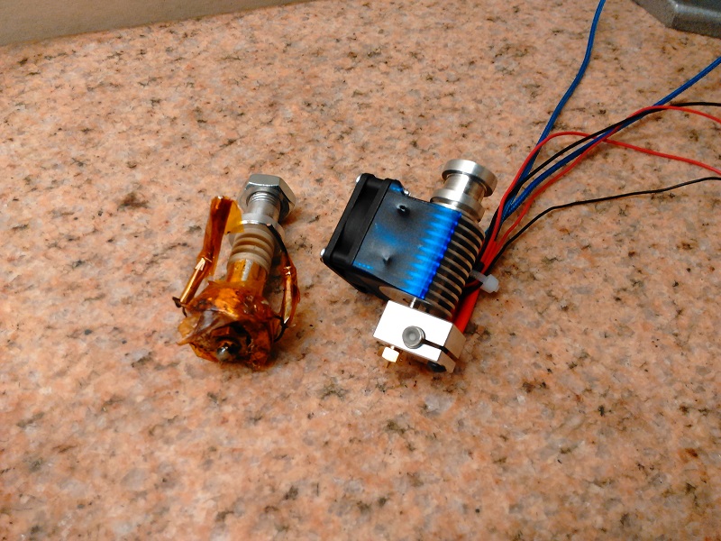

So after realizing my stock hot end is on it's way out I ordered the ever popular E3D V6 for my MaxV2. My question is, what is the best mount to use for this hot end? I know there are a couple options out there but I thought I'd get your opinions.

The 714 mount looks nice, but I have a hard time paying for something I can make my self. I'd print a mount, but my current hotend is toast. I guess that leaves one thing, do as I always seem to do, design and make my own.

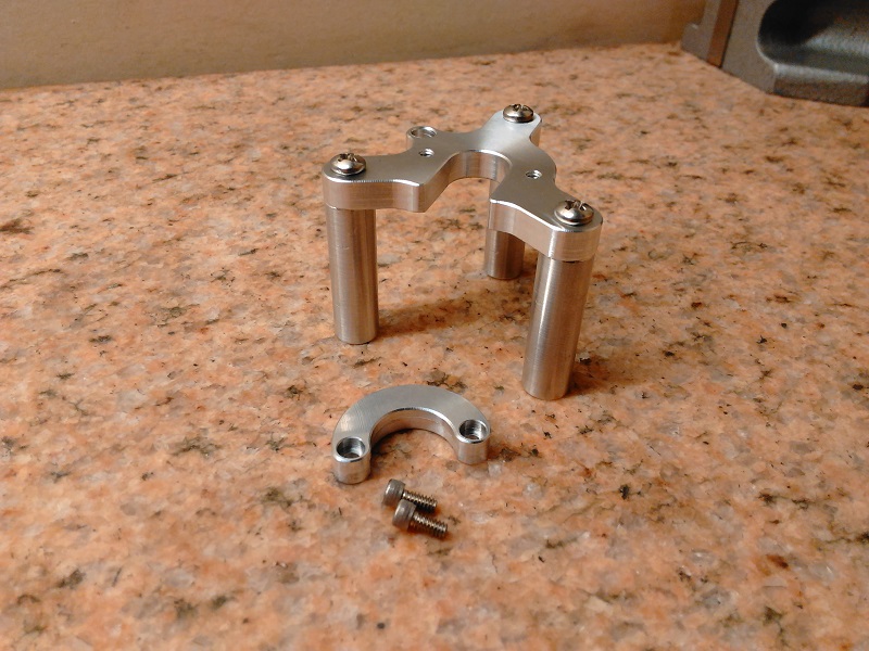

Alright so here's what I came up with. My E3D showed up on Friday, and by Saturday afternoon I had the mount designed and fully machined ready for action. I had one little snag though, since the PTFE tubing runs down inside the E3D, and on the stock hot end it stops at the bowden fitting, I didn't have enough length to allow the hot end to reach the bed out towards the towers
Oh well I'll have to order some.
The hole on the side is to allow the wires to pass thru and provide some strain relief.

I very much doubt it's illegal for you to sell it. 713 gets away with it just fine. All you've done is design something that goes between two standardized sets of mounting geometry. It looks like a nice solid piece of machining. Would you mind giving us a look at your shop setup sometime? I always love to see other people's work environment, and seeing how different machine shops are laid out is useful to people just starting their own (Which seems to be a number of people here, since 3D printers are a good lead into NC control)

Old thread, but I just came across it. This new mount appears to have a major benefit over the 713Maker mount (which I have). The 713 mount blocks access to the PTFE coupler on the groovemount top. It's difficult to manipulate it once the V6 is mounted.
This new mount doesn't fully encircle the top of the V6, so the coupler is easily reached.
This has become even more of a problem now that I mounted the SeeMeCNC accelerometer board on top - the coupler is now a good 3/8" (9mm +) below the board, making it almost impossible to handle the filament itself at the hotend. I'm thinking I'll have to print a coupler to go in-line with the PTFE a couple inches above the top of the board, which will allow the PTFE in the V6 to remain in place all the time.
