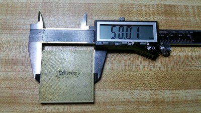

Calibrating the extrusion steps/mm is a good idea, but I found it to be somewhat tricky. You have to lay the filament flat and measure it, but it wants to curl, so it's hard to get a precise measurement. It's worth it to do anyway, to get yourself as close as possible. After that, if you use the calibration system I posted on Thingiverse, you will absolutely nail the rate of extrusion for every filament that you run the single-wall test with. That will correct for any error in the steps/mm setting. There is a catch, though. You have to measure the filament in multiple places for the slicer's sake, and then you have to do the single-wall print to perfect the extrusion multiplier, for EVERY spool of filament, even if it's the same color from the same manufacturer.
If the filament is still piling up near the loops, and your extrusion is perfectly calibrated, your Z height is too low. Try reducing it down by ~50 microns. Also, when it draws the first layer loops, look at how flat the filament is.
It should look like this:
It should be a little rounded on the side, with a flat top. If it's way too flat, it'll pile up, causing these issues. On the other hand, if it's totally round on the top, the Z height is too small.
