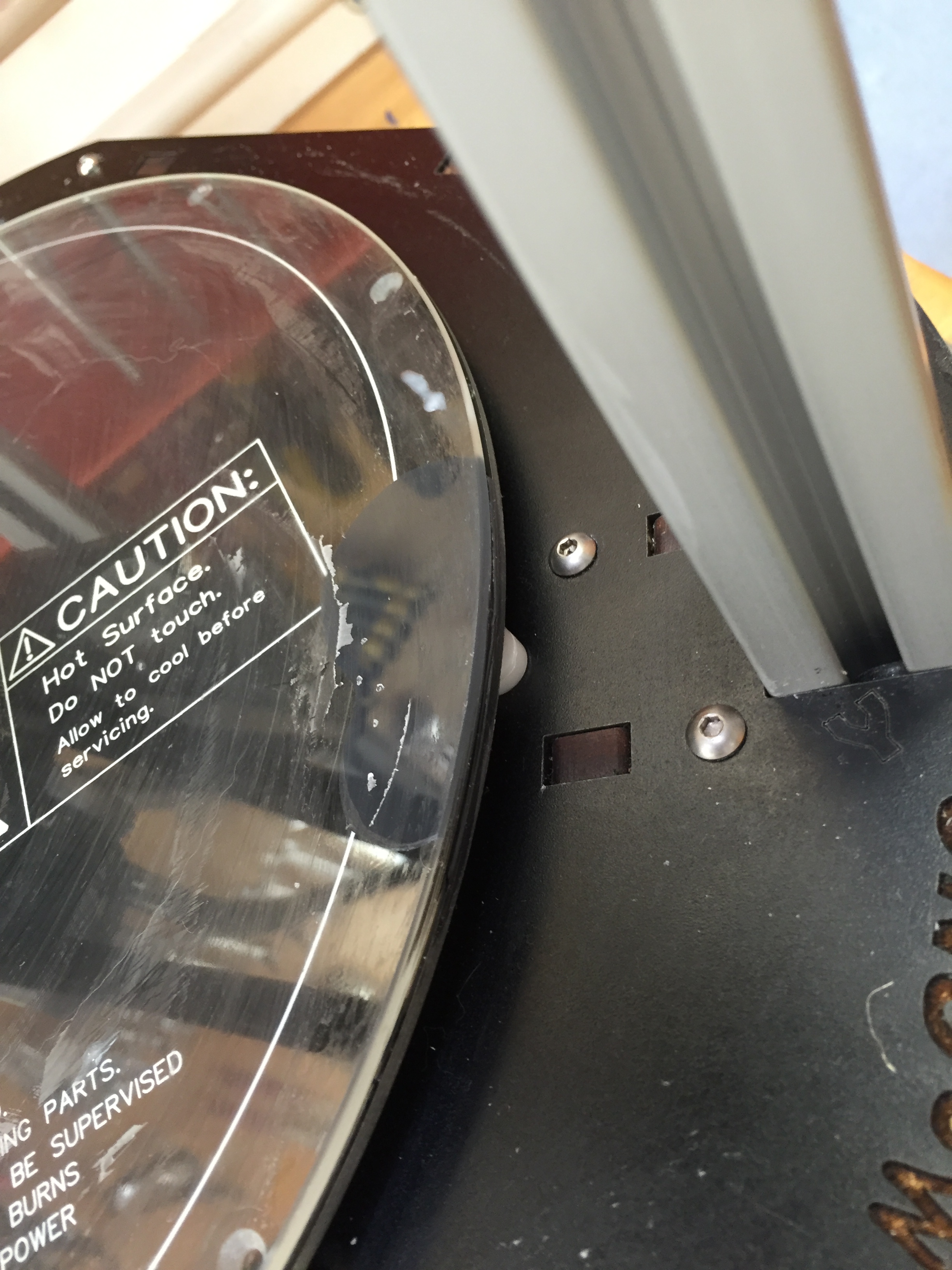

Re: So after weeks of scratching my head...
ill grab some photos when i get a chance.
i just used the existing holes in the base that are there for the snowflake.
i used longer screws, and the plastic washers off the snowflake to space the bed up (i think I used 2 or 3 each screw)
I think this setup nicely gives the onyx bed the ability to move expand by just bending the scews out very slightly. (they were only very slightly tight with a little locktite to hold it.
so the onyx is only held in 3 places....
The glass was held with 3 big blobs of black silicone directly above the fixing screws, with the glass very very lightly pressed down on top.
this allowed the onyx bed to remain warped by about 1.5mm at the edges, while the glass is still flat.- so what i'm saying is theres around a 1.5mm gap between the glass and the bed in places on mine..
it heats up fine, slightly slower, but at least the glass is flat!
The glass cannot straighten out the onyx if it is warped- as it bends it self, remember .05mm here is enough to stuff op the first layer.
I have heard people say it will on here- but i know from experience it will not!
good luck

Thanks Jason128 - I assume this is one of the big blop of silicon between the ONYX bed and the glass?
yep - that's the silicone- i might have got a little carried away!
A little blob spreads a long way when squished down.
